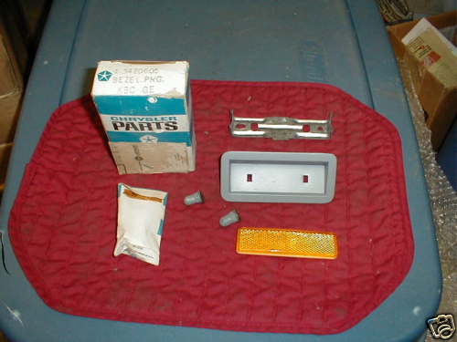

Item #1 the two caps , Not painted.
Item #2 the metal bracket , Not painted

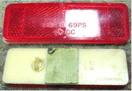

Item #3 back side with the wording 3 Top , Not painted,,,,,,,, Front side Painted Body Color and then reflector (red or yellow) snaps in.
