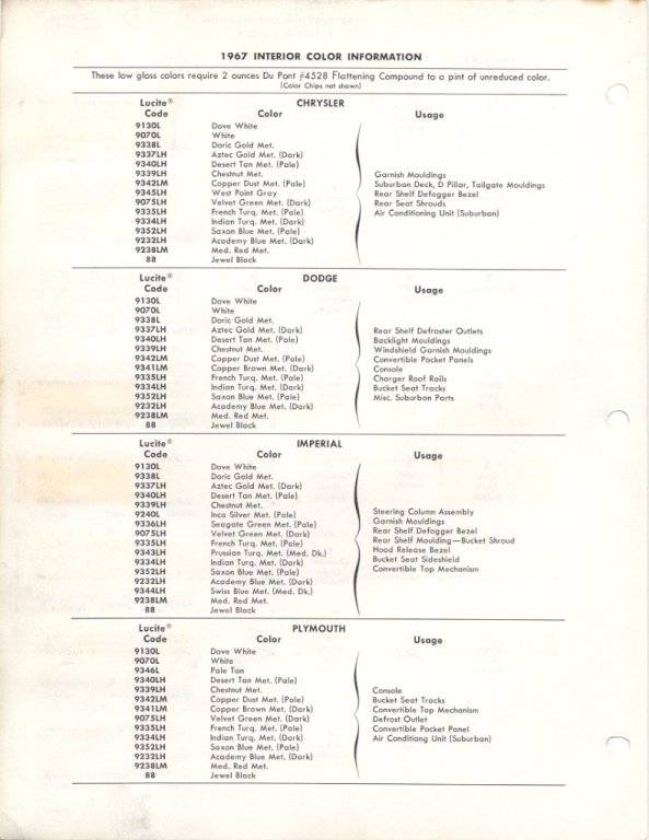

I found actual dealer paint chips for my 67 Newport on E-Bay as well interior color pages. The FSM manuals as well which paint/interior combinations that could be ordered. I also found a complete reprint set of factory assembly manuals. Car color and trim codes are on the metal fender tag that also shows the options from the factory. AS for the paint on the lower dash I am going to take the metal cover from under the steering column and have it matched. We have a body shop supplier here that specializes in classic cars that can do this for me. Going by the original formula used in the 60's may not work as paint bases, tints, thinners etc are completely different today from what was used back then. All you need is a piece that was not exposed to sunlight etc and the laser color matching will be spot on. Much cheaper to by a can and spray it with an airbrush than a spray rattle can but any good auto paint supplier can do this for you.

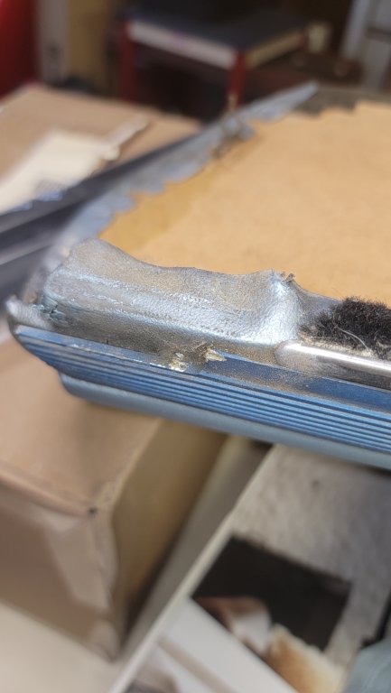

Any idea how to find paint for the metal tops of the Imperial (67) interior door panel? It appears to be a dark blue metalic. I looked through the various interior color charts and don't see a reference.
