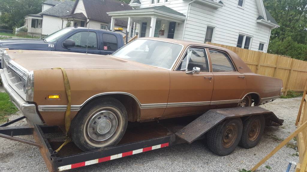

i have a 69 monaco 4 door.and am wondering if that windshield will fit in my 69 monaco convertable.or what window will fit in my convertable

No sir. Well it depends...what 4dr do you have? Sedan or hardtop? If it's a hardtop (no post) it will fit. Sedan...nope.
Convertible - 2dr Hardtop - 4dr Hardtop
Sedan - Wagon
I agree with Wyatt, though I will add that for my 70 Fury convertible, window glass and quarter glass are shorter top to bottom and for convertible only. I think front windshield may be the only thing with compatibility.
Yep, convertible side glass is specific. Vent windows are probably interchangeable, I've never had to look into it.
