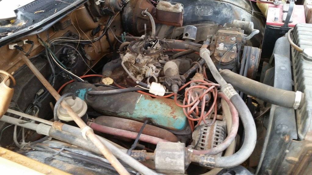

I don't think it was unusual for 383 4bbl cars that had ac to be blue or turquoise.
mine is a 69 383 2bbl with a/c and it is turquoise. and im fairly sure it's original lol
Not if it's an HP 383. Problem is, in '69 all 383s were simply a "G" in the VIN as this one is. I like in '70 where they made a distinction between L and N.

That's correct.
Really? Don't want to offend, but is it the factory motor?
Yup all original. Well maybe spark plug,wires etc been changed. But otherwise its original. Engine blew somewhere -89-90 and been sitting on desert since.
This car is sweet!
Where do you get your information? You post your information as facts when it is really speculation.
Chrysler always distinguishes a 2 bbl from a 4 bbl engine with different codes at least from 1969 and forward and probably in the earlier years as well (not sure) and as noted above the proper code for a 4 bbl is H in 1969. And I owned a 1969 Newport convertible a few years ago before selling it to Finland, and it was a 4 bbl painted Chrysler blue from the factory - no doubt about it. In a B body like a 1969 Road Runner, the engine would have been orange, but not in a Chrysler. And the engine code for a 2 bbl is E61 whereas a 4 bbl is E63. This Newport convertible started life as a 383-2 bbl., G code.
I, like anyone else, can be wrong. Where I got that information, not a speculation, incorrect as it is, was from a Chrysler Engine Rebuilding book published close to twenty years ago. I see that his comment about the "G" code being universal was incorrect, but that was where I read it. I don't recall making any comments about the Fender Tag engine codes, so I don't know why you bothered to make those points.
