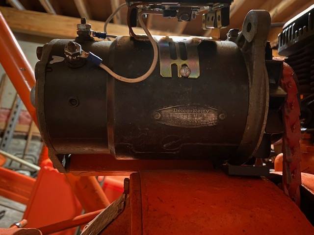

I've got an old Economy Country Squire tractor that I've been picking away at since 2012 and I'm finally gettining down to putting the electrical system into it. It's a 6v system with a geared starter (Auto-lite MAK 4008 which I've been running for about a year, hooked up negative ground) and a Generator (Delco-Remy 1100036 which was rebuilt). The generator basically charges the battery and runs only three lights.

1.) How can I tell if the Gen is negative or positive ground?
2.) Assuming the Gen IS positive ground, does the battery (which has been charged as standard neg-neg, pos-pos) need to be completely discharged and recharged as positive ground (neg-pos, pos-neg) in order to safely recieve charge from a positive grounded Gen?

The generator will work with either a positive or negative ground as long as it is polarized to type of ground that is in use. A word of caution, if your system has a positive ground, you should probably keep it as there is no real advantage to changing. A lot of these older tractors had induction type ammeters, those are the ones with a single wire running along the back of the ammeter. If you change the ground from positive to negative, the ammeter will run backwards.
When the generator is installed, the field is grounded to the generator case, the generator is grounded to the engine block. The positive or negative cable is grounded to the engine block. All you really have to do to change the polarity of the generator is to span the bat terminal to the field terminal on the generator, a short touch with a screwdriver is all it takes.(Do this with the battery hooked up)

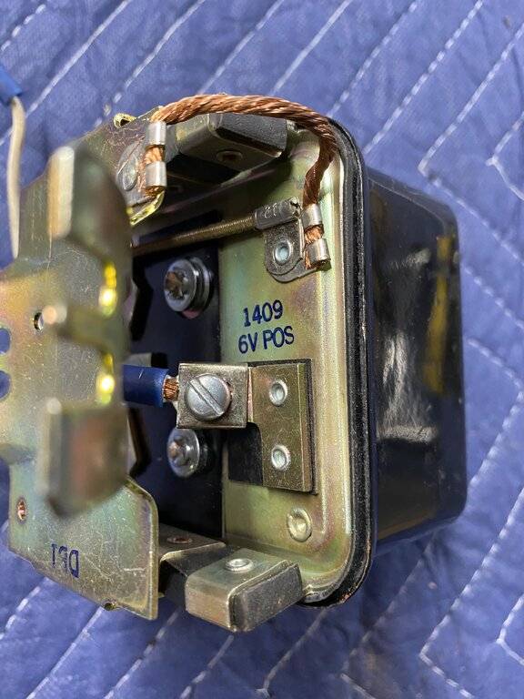

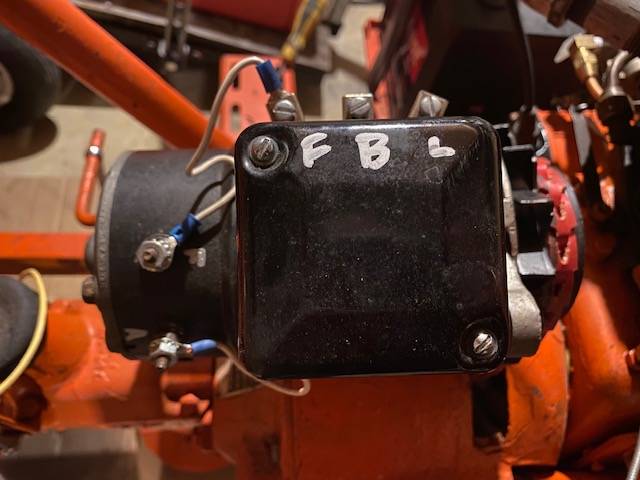

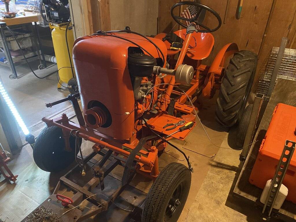

Man, I got nothing. I polarized both at the VR and at the field terminal (after doing it at the VR failed) nothing. Showing nothing on the ammeter or at the battery (at any RPM). I tore the system back down, took the belt off and it motored so I assume the gen itself if ok. I just have no lights or charging. The field and armature connections seem fine so I’m assuming the VR is crap... though I can’t understand why, it’s 5 years old and never been used.

Here's what I don't get though, I'd assume that if this regulator was working and I ran it backwards, there'd be a smoke show of sorts. If I was getting nothing when it was running before, it's not going to make any difference whether I'm neg or pos ground at the battery, correct?
I wonder if I shouldn't get a new neg ground VR. I was really hoping I could figure this out without buying anymore crap.

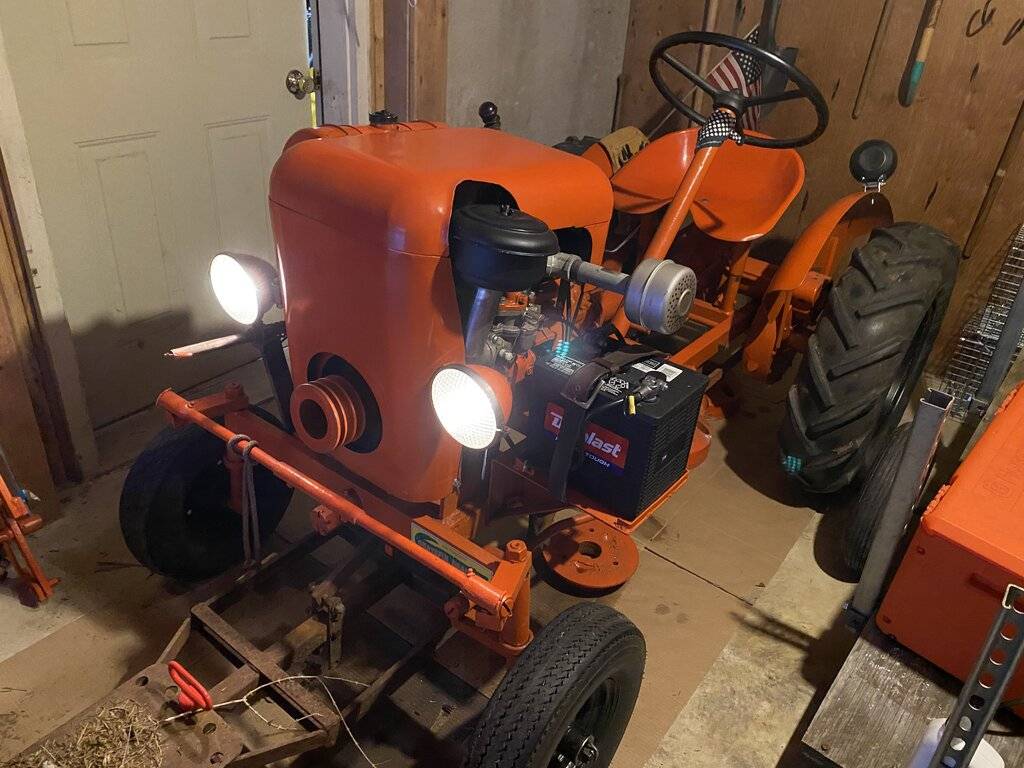

Bunch of needless confusion, stupid questions and bad grounds later:
leadin’ the ole Chairge. Thanks for the help, guys.

Not too too much to say really. I’d determined that the VR was meant for POS ground (as it was marked as such) so I basically cleaned all grounds and verified continuity (for charging and for lights) then I polarized it for POS ground (neg jumpered to armature post briefly) and that was about it. I still don’t understand why nothing bad went down trying to run it neg ground but...
I noticed the needle jumping around at higher RPM which I’m assuming has something to do with the brushes sticking in the gen. It sat in sort of crappy conditions after it was built 5 years ago. I’ll have to pull that and clean everything up, see if I can correct that.
