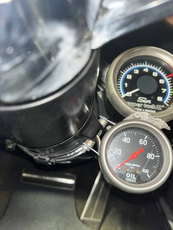

Murray’s a busy guy these days, but he’ll pick up the phone eventually- call him again. Many years ago, I pieced together a tilt column for my ‘66 300 (it was my brother’s at the time), I used a ‘65 NY non-console column (all that I could find, pre-internet- obviously I’d rather have tilt/telescope). Anyway, I had to use the non-tilt shifter collar. I thought about shaving the shifter mount off and filling it but I realized that it was a perfect mount for the oil pressure gauge. Works great!

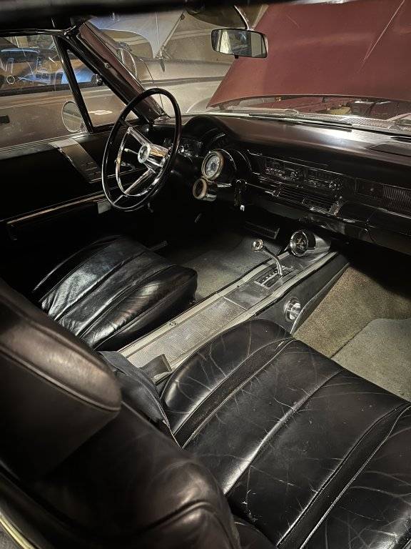

I thought about trying to piece things together with my console shifter and the T/T column shifter but the general consensus seems its not recommended. I'm going to start with the path of least resistance and see if I can find a T/T console shifter first, and then move on from there. Thanks for advice.

C. Using the shifter lever boss as an oil-pressure gauge mount was a perfect solution for me, as the car is heavily modified anyway!

If you could send a picture of your oil gauge set up on the shifter column I would be curious to see how that came out. However, I have already mounted my 3 gauge cluster and Tach....

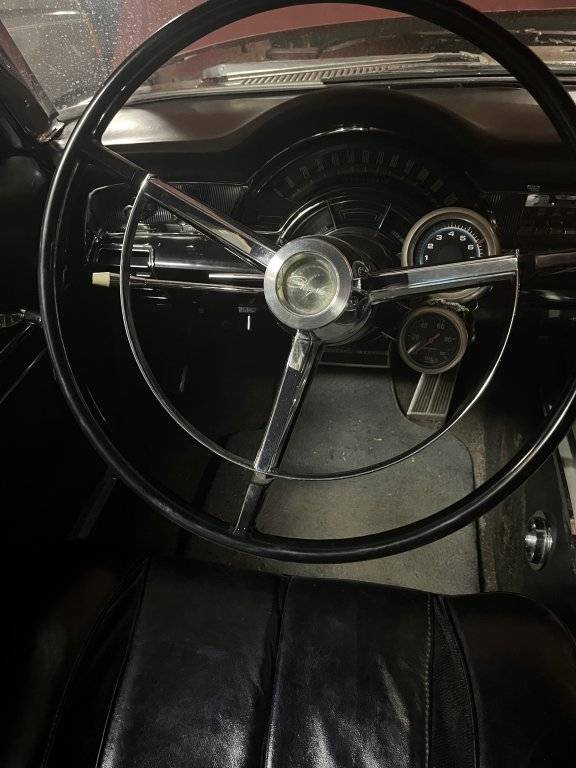

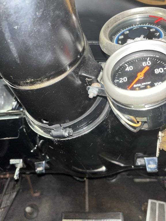

I’ll try to get a pic, this weekend!
Got over there sooner than I thought.
I’d forgotten that I was able to rotate the collar 120 degrees.
Very clever ingenuity. Appreciate you sharing the photos. On a side note; never received a response from Murray (left a couple messages). Wondering if he's still in business??
Thanks for the compliment! Just keep trying to call Murray. He’ll pick up. Mornings are the best time to reach him.
