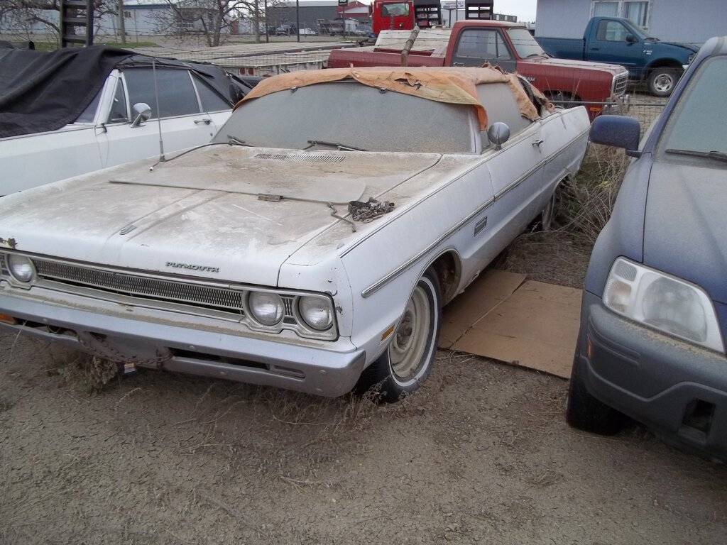

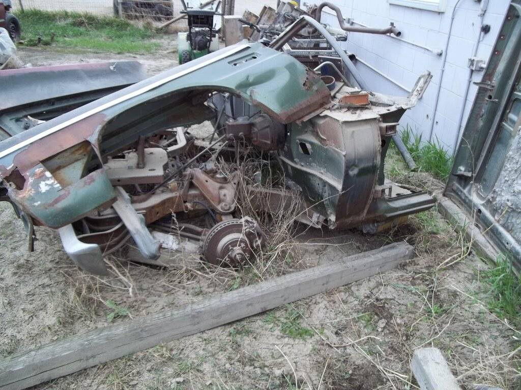

I was told my 70 would be torsion quiet, I climbed under it and its solid mounted like the 69's I've had apart, it's definitely a short stub not like the 71-73's, so could I use a 69 stub?
In reality I guess I need two stubs as the Sport Fury has about 12" missing from the drivers frame rail behind the control arm.
I just want to make sure I'm searching for something that is actually going to fit my turds.

No Plymouths got torsion quiet in 1970. Never heard an explanation of exactly why not. May have been doing a little experiment to see if having an upscale feature on the Dodges that you couldn't get on a Plymouth would boost Dodge sales.

Convertible and wagons got the short stub in '70 Chryslers. Every other Chrysler got the long stub with the isolators.
