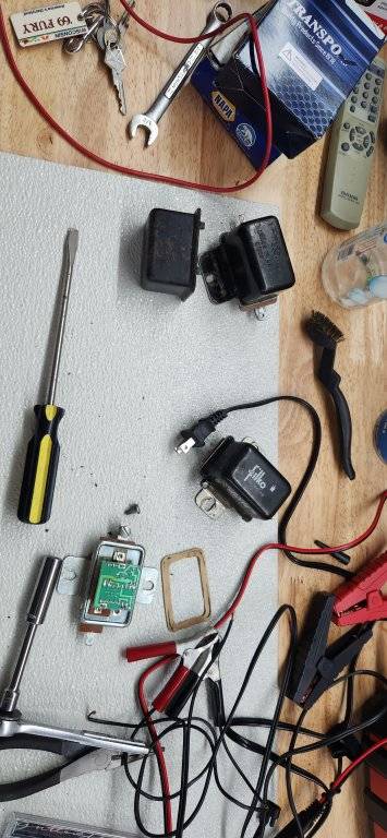

I put an original mechanical type VR in that I had laying around and i'm back to getting battery to charge - though my aftermarket voltage gauge is jumping around 12-14 at idle but holds steady at 1000RPM and up.

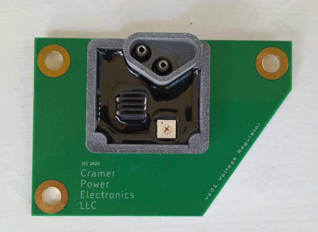

There is a guy on the slant6 board (MadScientistMatt) that designed and produced some new 70-up regulators this year that are adjustable and have well-specified, temperature-compensated characteristics. He's selling them here:
https:// cramerpower . com/products/adjustable-voltage-regulator-fits-1970-and-later-chrysler-dodge-plymouth
that is wild looking!

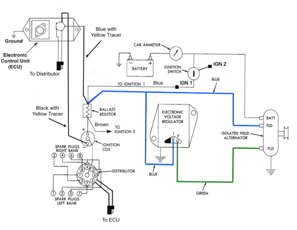

To connect the new regulator, refer to the following drawing and do the following:

Diagram of 1970+ voltage regulator with electronic ignition wiring with the regulator wiring highlighted:

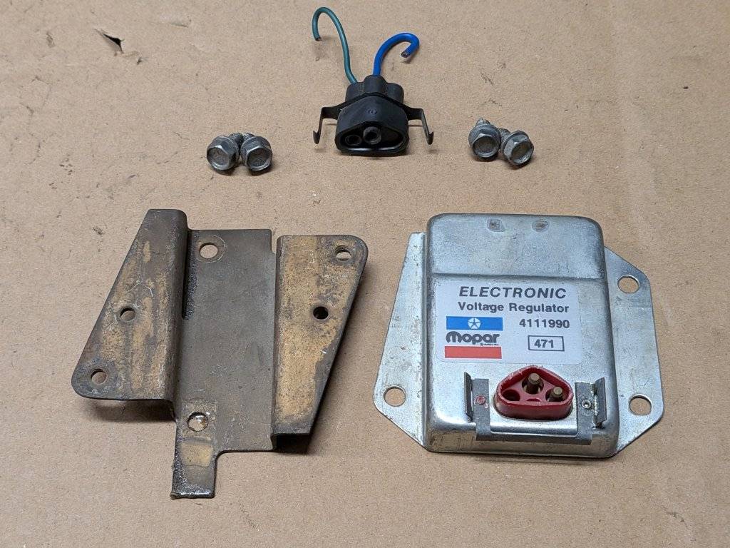

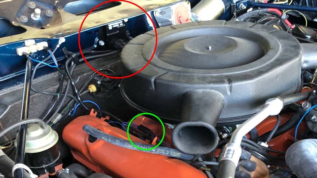

To easily mount the new style regulator in place of the old style, locate and use the adapter bracket from a 1970 B-body. Mount the adapter bracket to the firewall, then mount the new regulator to the bracket. Ensure good grounding. Use the original style bolts with the barbed washer if possible.

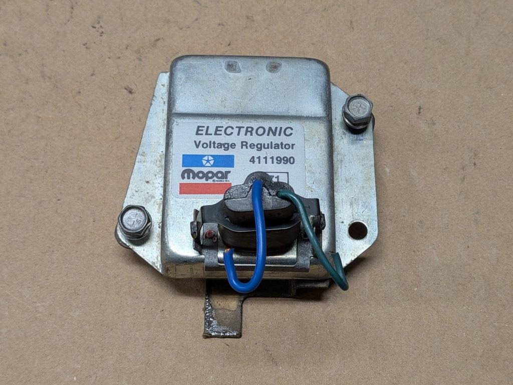

The following images show the adapter bracket, a voltage regulator, connector/pigtail, and bolts:

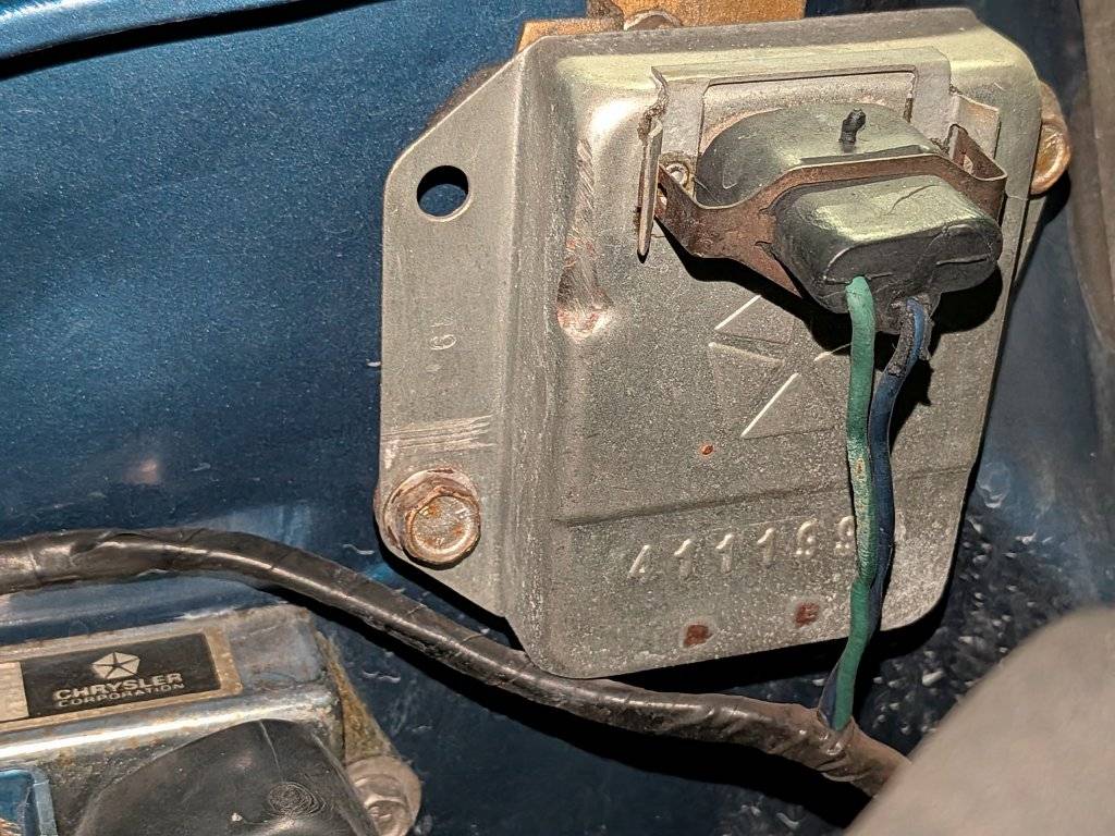

The following image shows the bracket with regulator installed on the firewall of my 1967 GTX that I converted about 30 years ago:
NOTE: The voltage regulator pigtail, part number 2983727, was available from Chrysler but now discontinued. A good used one from a scrap wiring harness can be used or new aftermarket is available. Standard Motor Products S-573 is commonly available. A metal retainer, part number 3588348, was also used. Replacement pigtails do not have a retainer, and it is best to use one, but a tight molded connector can hold without it.

That Filko brand regulator you have there is one of the best in the business. You can still find new ones for sale on E bay.
