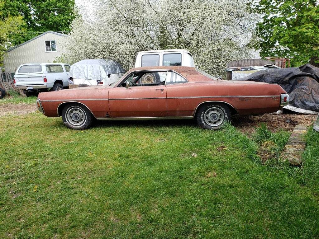

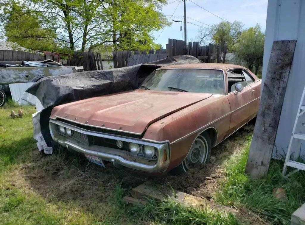

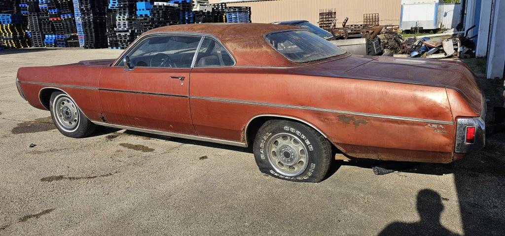

As many know, I recently acquired an FK5 70 Polara Custom 2dr hardtop. 383-2 but what made it unique to me besides being a good color, was the fact it's an original Superlite car.
Photos from the FB ad :
I had the car shipped from Spokane to Rockford and started formulating a plan for resurrection of this neat old car with parts I have already, or know about.
Once it arrived I had several leaky tires and I wanted a solid set of 4 for when I have it running in the not so distant future.

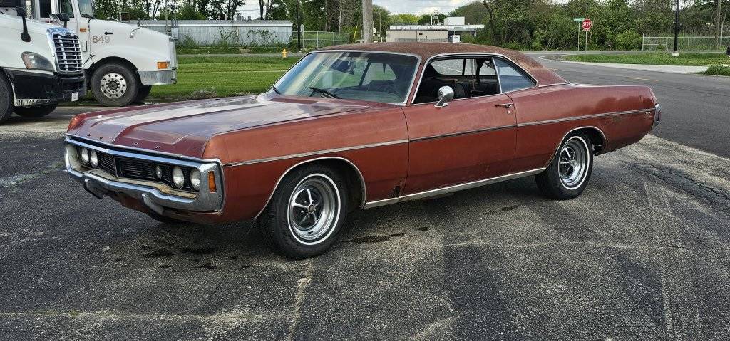

I held onto the H724 Hankooks from the Servpros old road wheels for a rainy day. I came across a set of 15x6 Magnum 500s I've wanted to try for a while locally on FB from a friend. I couldn't find any markings on the wheels I imagine they are aftermarket repops.
These will work for the time being, and I like the look! Especially with the white walls out, a first for me, maybe I am growing up some? Probably not. Special thanks to @sixpkrt for providing me with a missing center cap to complete these wheels.

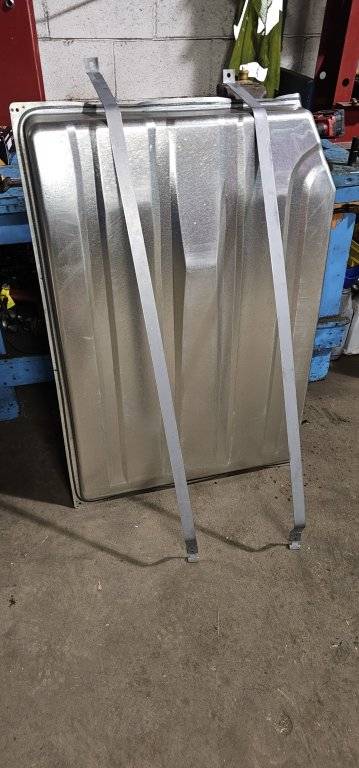

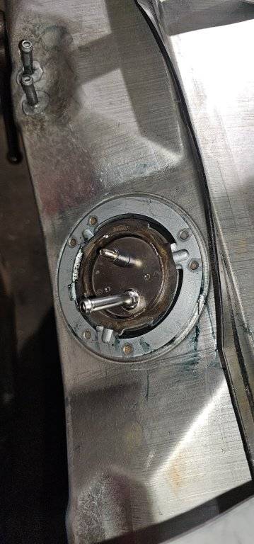

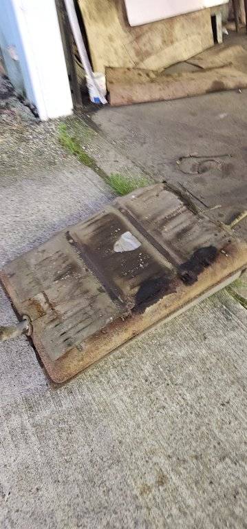

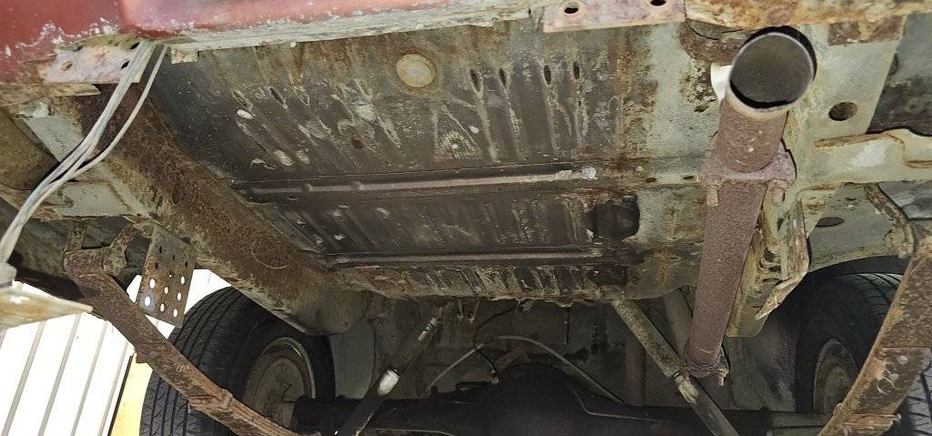

That's where we are currently. I've removed the trailer hitch and that gave me access to remove the old fuel tank that was about 1/2 full of 10+ year old fuel. I ordered a new tank/straps/sender from Vans and got it installed in the car last night. New sender was installed with the original lock-ring after some wire brushing.

Hope you replicated the fuel sender clamp/ground situation with the new tank.

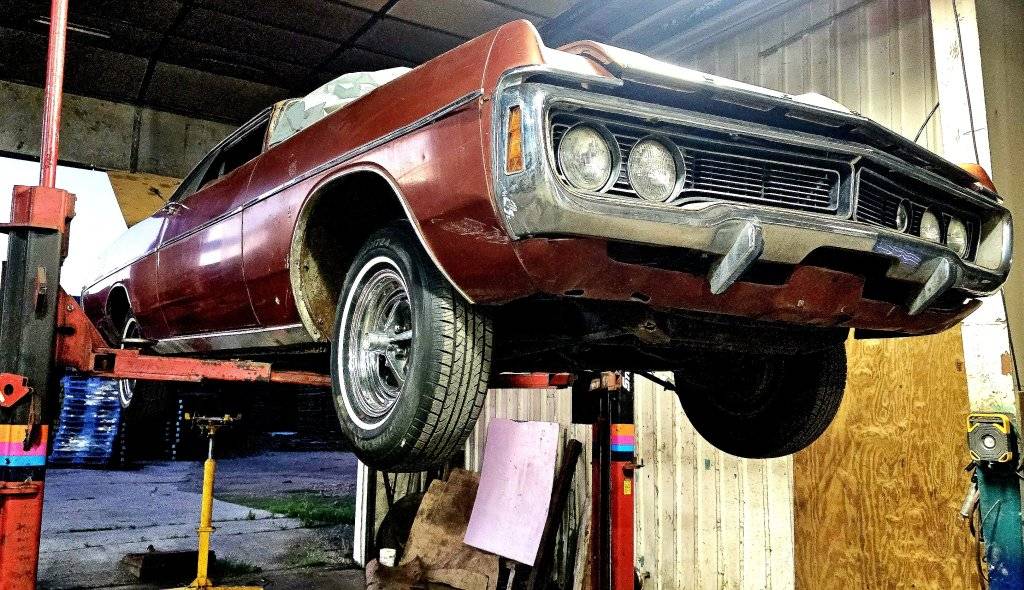

Swapping the other short pieces of exusting fuel line for new should be easy with it on the lift.

How long did it take to swap the tank out, 2 hours?
I think it took longer to figure out the hitch than to remove the tank...which I just cut the straps instead of fighting dirt/crap filled threads on the J bolts I re used.

Wyatt: check the vent nipples carefully. The tank I bought from Vans had cold solder joints that cracked causing a gas leak when I filled the tank.
Same thing happened with my vans tank. I didn't think soldering galv. steel would be that difficult...
