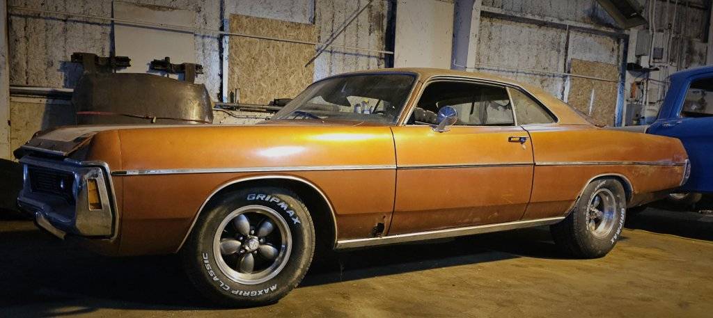

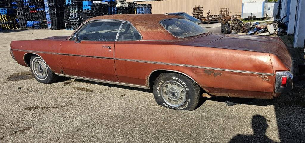

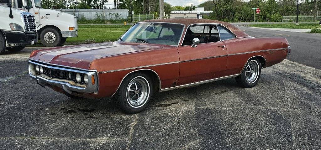

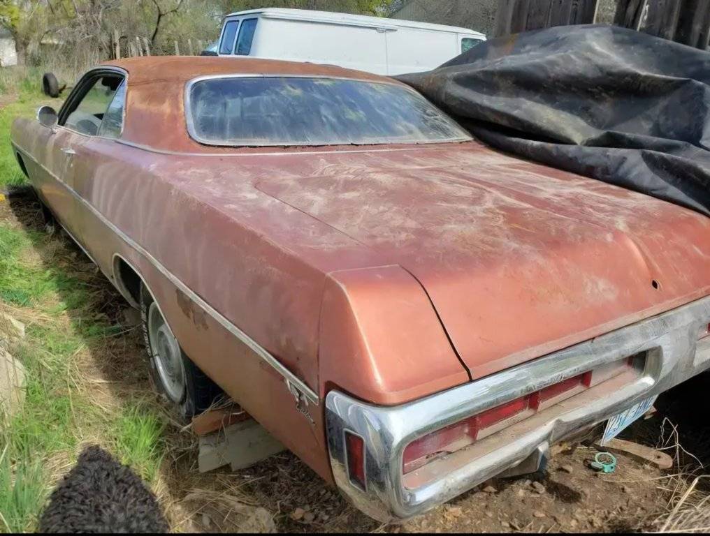

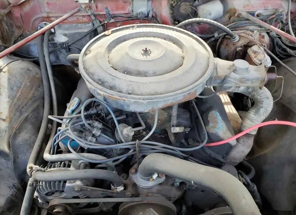

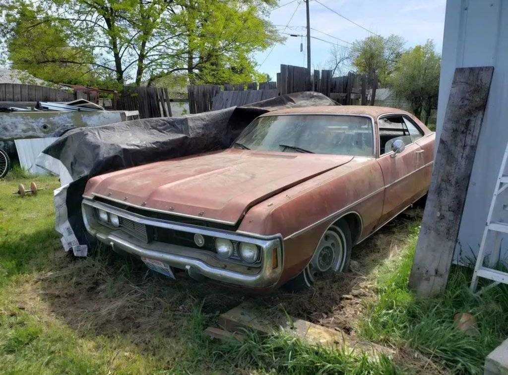

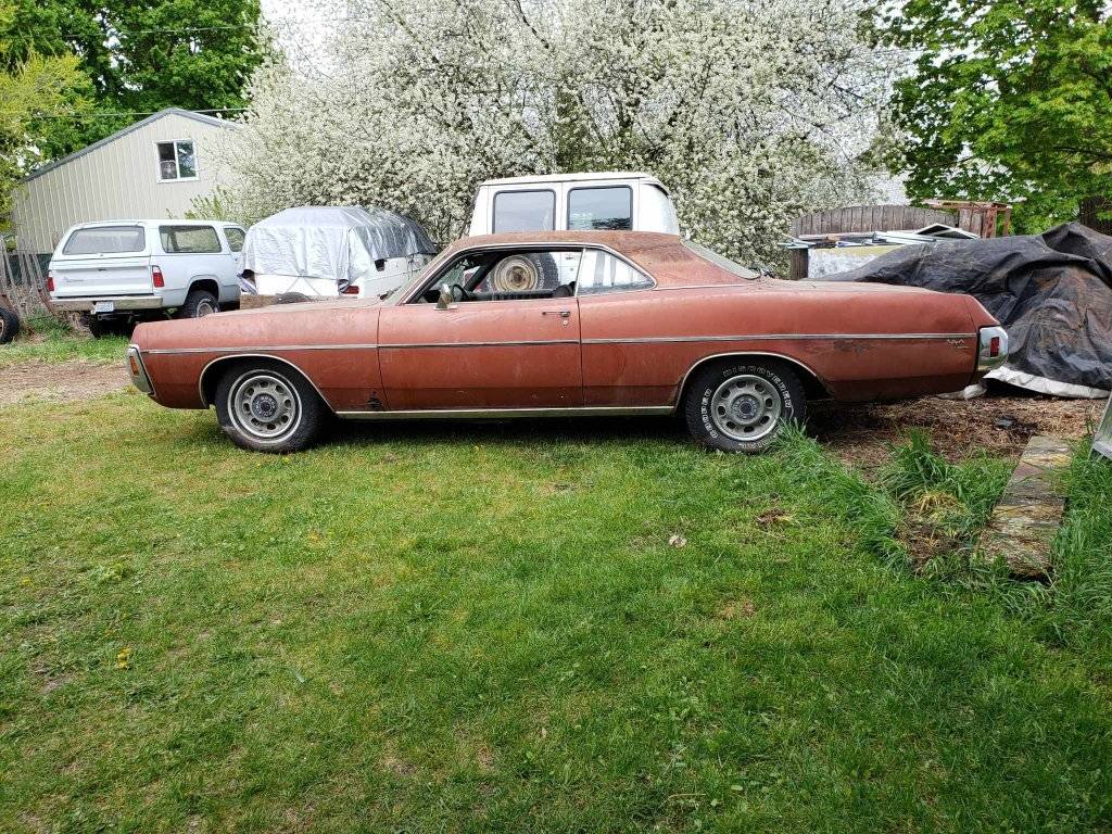

As many know, I recently acquired an FK5 70 Polara Custom 2dr hardtop. 383-2 but what made it unique to me besides being a good color, was the fact it's an original Superlite car.
Photos from the FB ad :
View attachment 668348View attachment 668349View attachment 668350

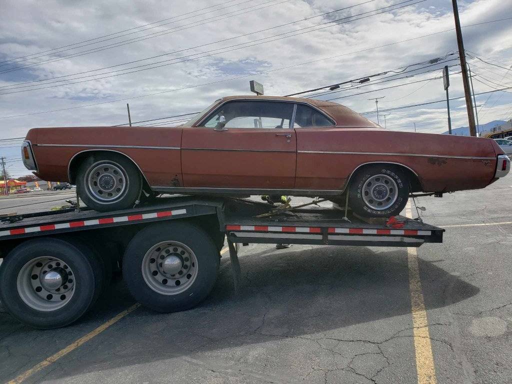

I had the car shipped from Spokane to Rockford and started formulating a plan for resurrection of this neat old car with parts I have already, or know about.
View attachment 668351View attachment 668352

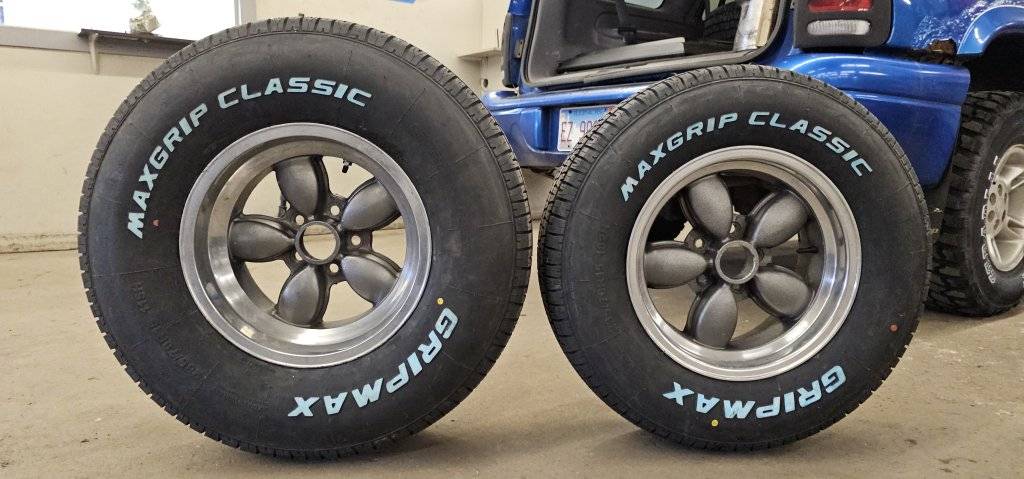

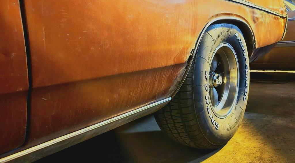

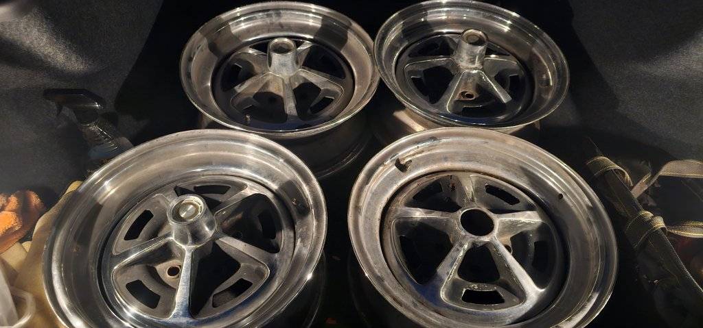

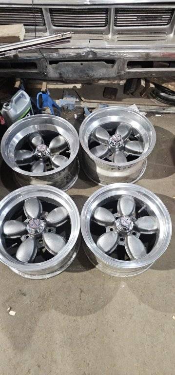

Once it arrived I had several leaky tires and I wanted a solid set of 4 for when I have it running in the not so distant future.
I held onto the H724 Hankooks from the Servpros old road wheels for a rainy day. I came across a set of 15x6 Magnum 500s I've wanted to try for a while locally on FB from a friend. I couldn't find any markings on the wheels I imagine they are aftermarket repops.
These will work for the time being, and I like the look! Especially with the white walls out, a first for me, maybe I am growing up some? Probably not. Special thanks to @sixpkrt for providing me with a missing center cap to complete these wheels.

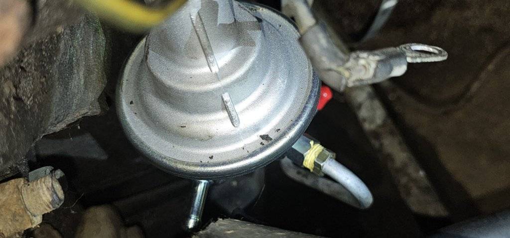

Is that sealant or tape on the threaded fitting? If so, you shouldn't need that, it's an SAE 45° flare fitting, and should seal fine w/o sealer.
Same flared fitting style as the brake tubing.
Yes I believe it's a stock replacement. Carter M3672. I've been searching for one with the proper size outlet threads, I tried this one and it's perfect.
Shouldn't need it. Doesn't hurt to have it though. And it's rated for fuel.

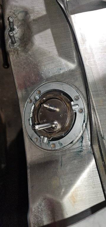

That's where we are currently. I've removed the trailer hitch and that gave me access to remove the old fuel tank that was about 1/2 full of 10+ year old fuel. I ordered a new tank/straps/sender from Vans and got it installed in the car last night. New sender was installed with the original lock-ring after some wire brushing.

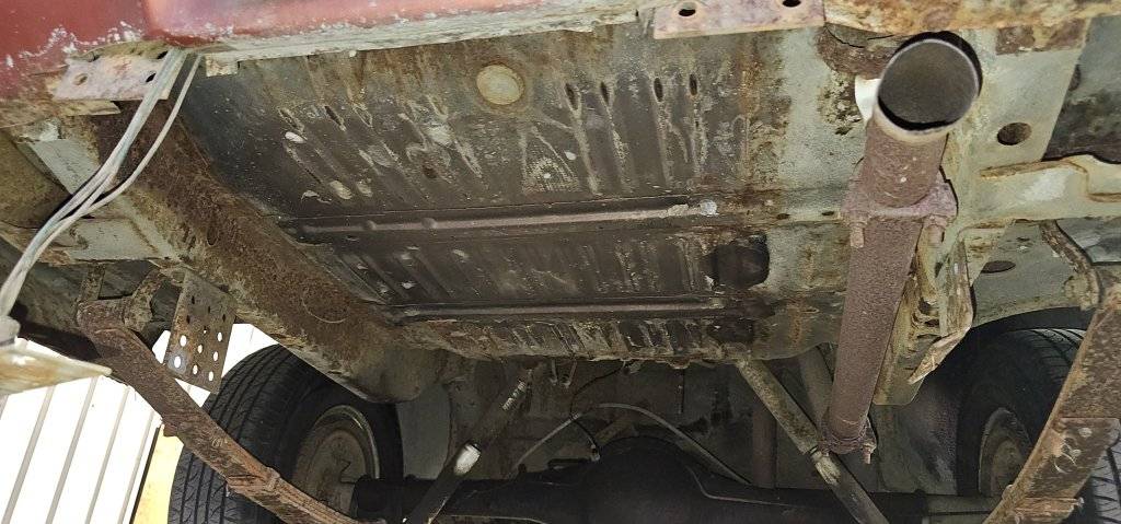

I can see that the trunk is in decent shape and doesn't appear to have any rust holes.
Rear frame rails seem to have some rust but doesn't appear to be any rust through.

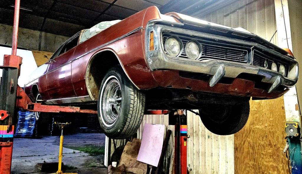

What's the rest of the bottom of DM23L0R136653 look like? End up with any real rust?
Glad it was saved.
It's got good bones. Normal fuselage rust in the Dutchman. Trunk is thin. Passenger front floor is suspect. Stub got smashed and ripped on the passenger side. Definitely patch-able, but may source replacement in the future.
