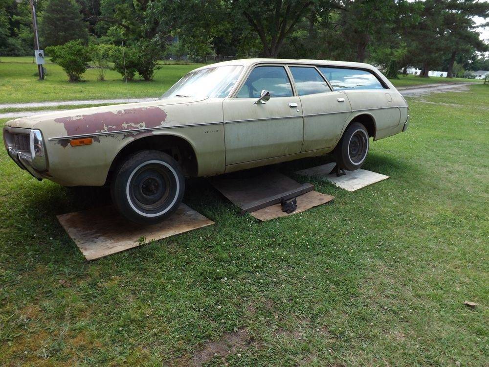

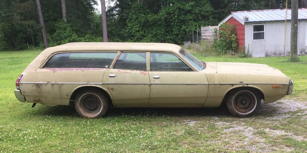

I've searched but can't find a 72 wagon with a RR or charger front clip. Will it even fit? Anyone seen one or have a pic. I'd think it would be pretty sharp.
Ive seen a green 72 Satellite Wagon with a two door Satelllite front clip. It didn't work for me. But a least the guy is enjoying his car & it's not rotting awayI've searched but can't find a 72 wagon with a RR or charger front clip. Will it even fit? Anyone seen one or have a pic. I'd think it would be pretty sharp.

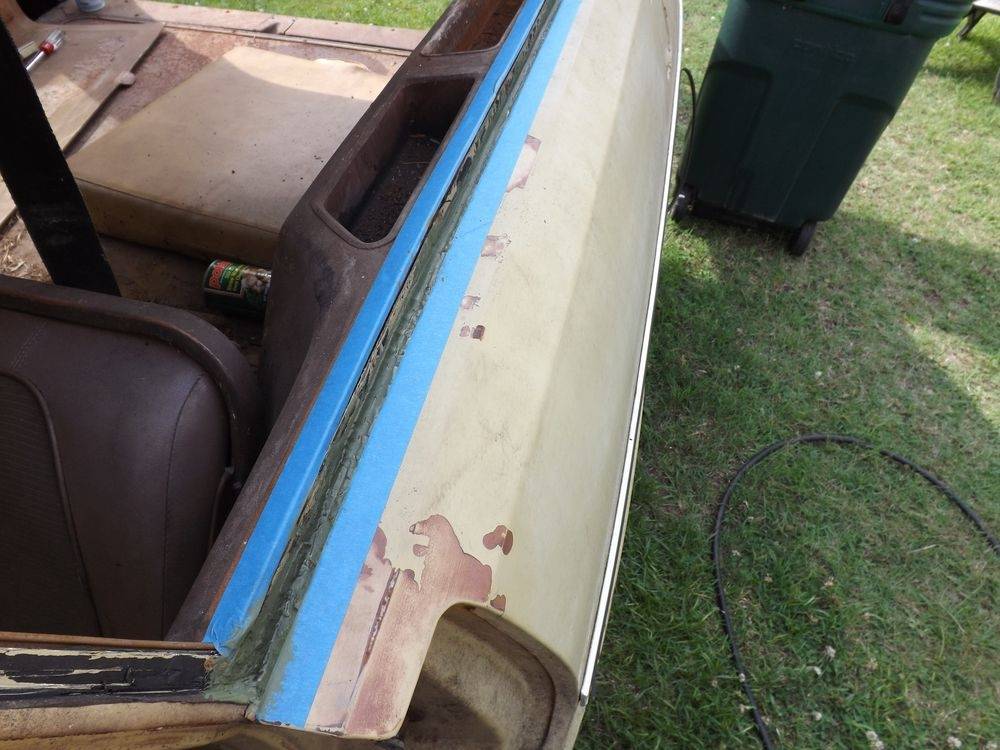

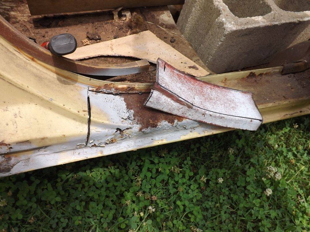

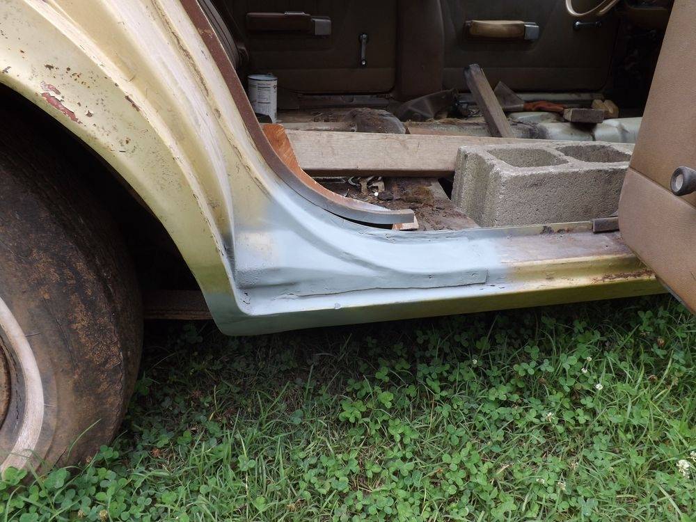

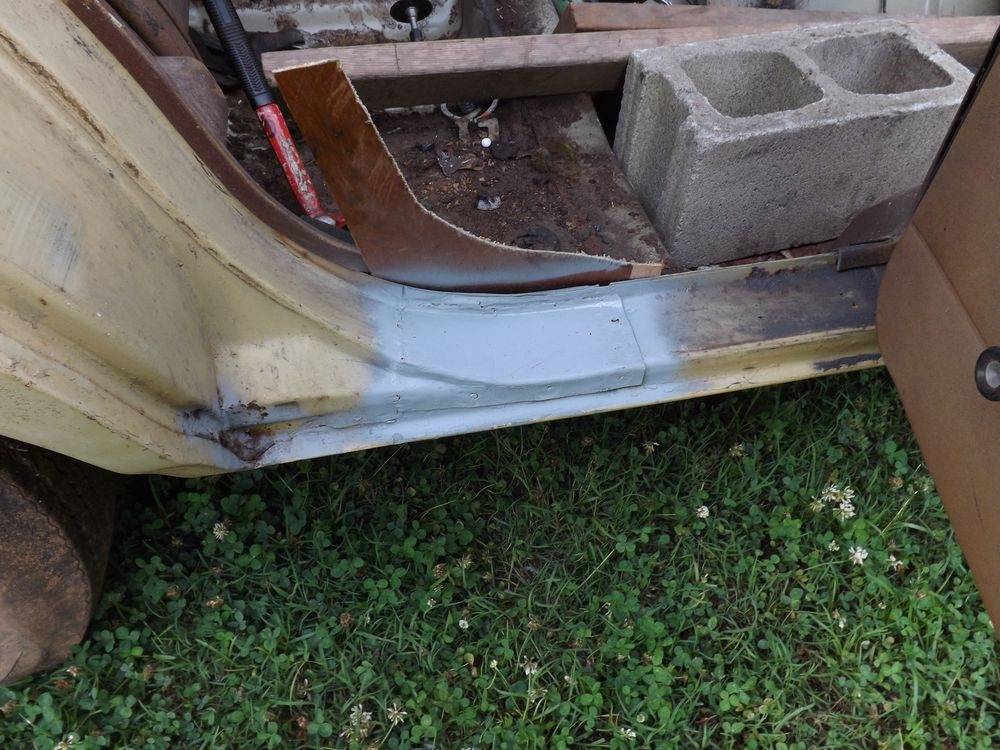

Awesome Gary !Got the fresh batch of weld through primer in today so was able to prep the passenger panel and weld it in, also did some patchwork preparation on the door jamb on the rear door area. The contoured patch is almost ready to be used. More pics to follow.
View attachment 126511 View attachment 126512
Yes that is what I use, the brand i use has something like 90 percent zinc content.What do you use for weld through primer? I could only find it in a rattle can.

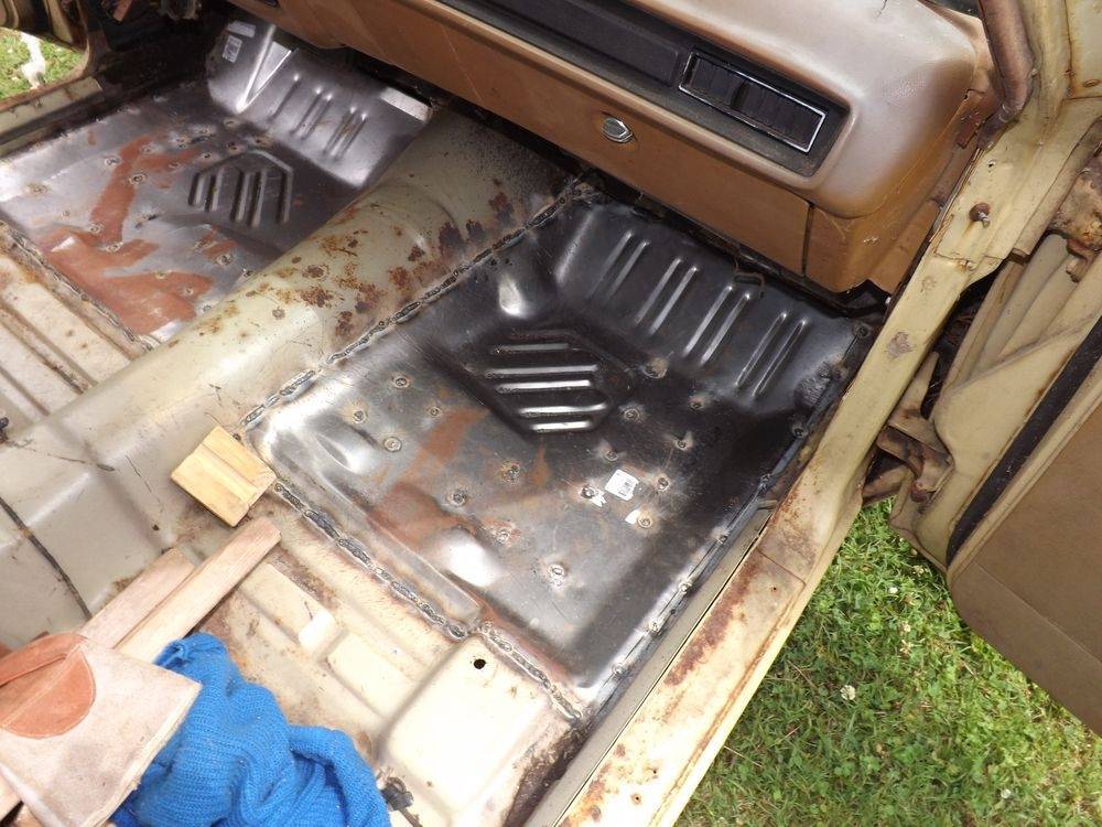

That's the reason I took the car to you. I knew it would be done right.Rain rain rain, again, this is driving me nuts, all I got done today was the welding in of the door arch and primering it.

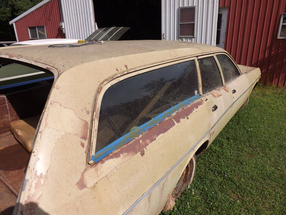

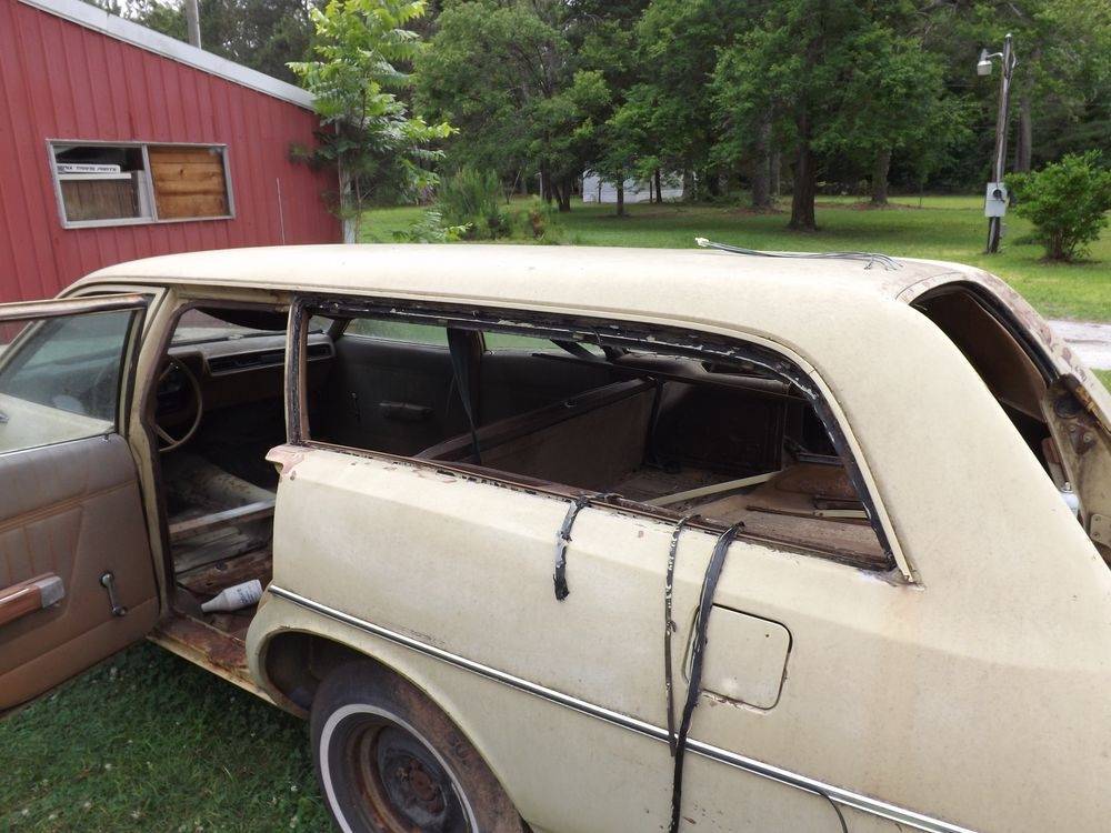

While waiting on some rear footwells I popped the side window and cleaned the channel, also coated it in zinc chromate, did the other side too as I could see it needed doing too.
View attachment 127457 View attachment 127458 View attachment 127459
