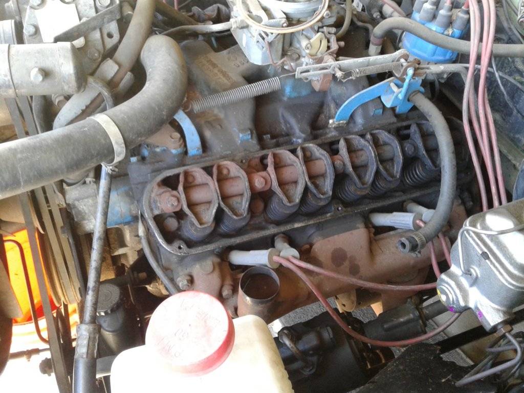

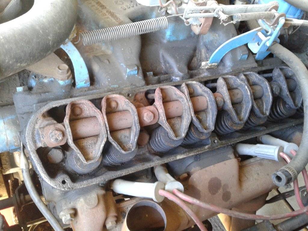

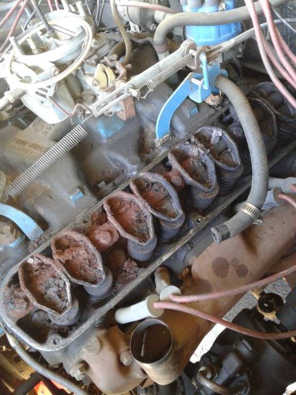

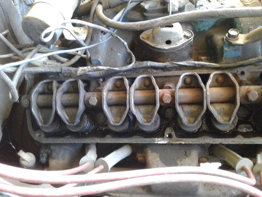

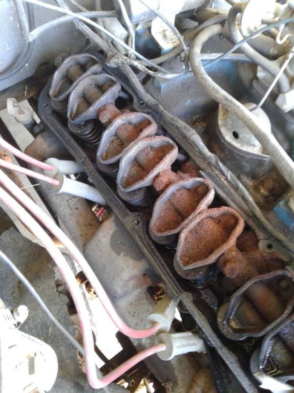

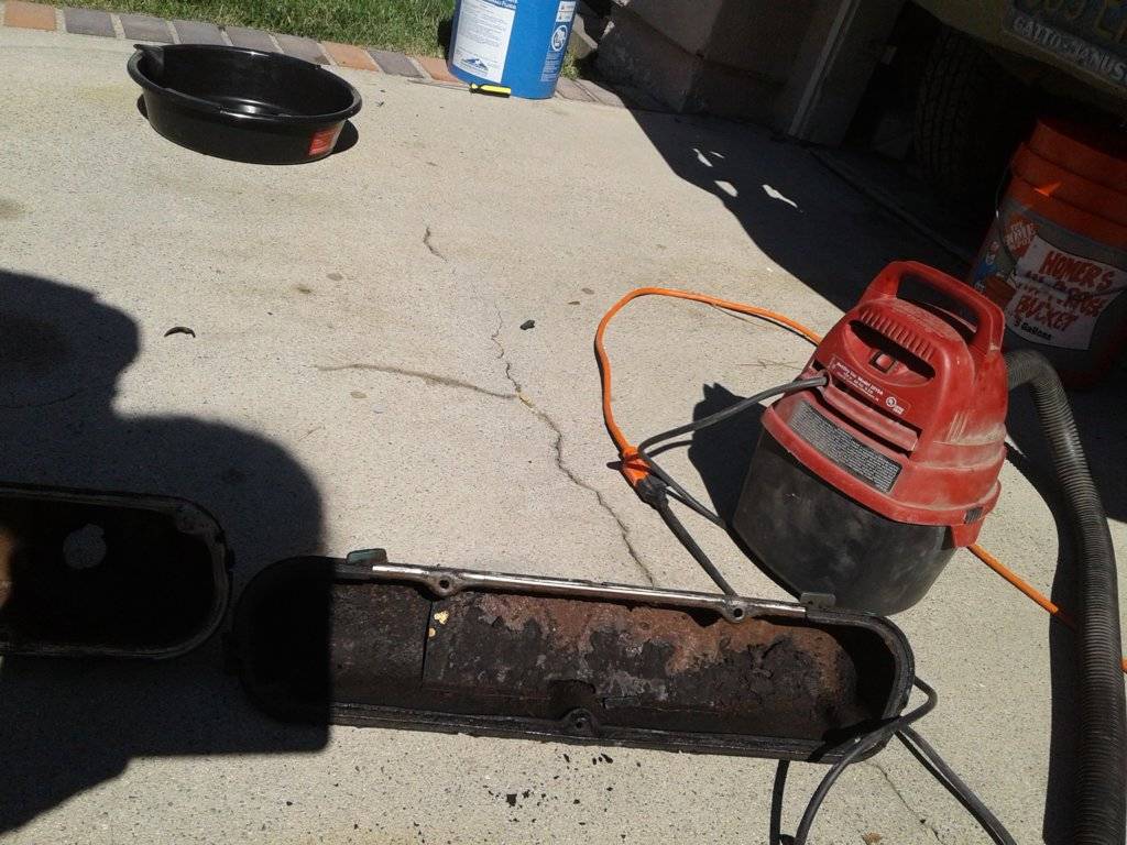

Pulled the valve covers...OMG!!
Used a vacuum to get as much as I could and I'll change it and do as suggested with some detergent stuff..the gaskets were toast... I bought the fuel pump so maybe I'll just change is proactively as I'm already in there.. headed to get a creeper... the bottom is nasty with cobwebs and crap so I'll vac that out. The underside is clean as heck...really shiny and zero rust and it shows nicely where the tank covers it up...

Holy crap. I'd pour some oil over those rockers before i put the valve covers back on.
Actually, I'd pour some oil over them, then start it just to make sure oil is getting to the top end.
Wow.
I'd put some oil in the cylinders too while I was at it. let it soak for a few days before trying to spin it. Just to be sure.
I think I would pull the intake manifold too. I have no idea what that crap is on the rocker arms. At minimum, pour some oil on the rockers, as was suggested.

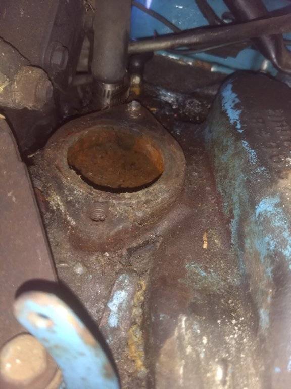

NEW PROBLEM
Pulling the thermostat housing, broke the head off one of the bolts...uuuugh!!
soaked overnight and doesn't budge...vice grips just slip...
I tried heating the manifold with a torch and didn't make any difference. Went to Harbor Freight and got the only extractor set they had but none of them fit the bolt!
I know the the worst case is to have to tap a new hole.
I have also managed to lose the other bolt... Does anyone know the spec for the bolts? I went to O'Reilly and all they has was 3/8 by 16 and I tried one in the other hole but it wouldn't go far and I'm not into forcing it.

You will be wanting to pull those rockers and hot tank them as well, rust is a potent abrasive and you do not want any in the crank case. Have you put a socket on the damper bolt to see if this engine will still move? T-stat housing bolts are not anything special, grade 5 bolt the right length will do. Getting them out can be a pain when they break, if all else fails, try drilling a small pilot hole down the center of the broken bolt thru the bottom of it and fill the cavity with penetrating oil, this will get oil to the lower threads and help free it up. One you get it out, you will probably need to clean both holes with an 3/8" NC tap.

We had hooked up a battery before I bought it and cranked it no problem for less than 5 seconds just to make sure it spins. That nasty stuff was very powdery and vacuumed right up....want to make sure you noticed that some pics were before and others after vacuuming.. going to put some oil in the cylinders....I was thinking something that would "mist" so it would spread across as much surface as possible because I think if I just squirt some in it will simply pool at the lowest point....what do you think? The oil I drained was pretty black but flowed really well and wasn't thick or chunky...
I would be worried about the rust and other gunk on the inside of the rocker shaft where you can not see it, that is why I suggested tanking the shafts. Misting the oil in the cylinders is a good idea or you could just run about 3-4 oz of diesel in each and crank the engine over to blow out the excess. Most of the moisture collects on the bottom side of the piston as that is the lowest point and that is where you would most likely find rust on the cylinder walls.
