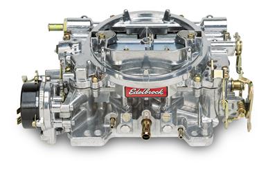

You need an Eddie 1411 carb. 750 cfm with an electric choke.
http://www.summitracing.com/parts/edl-1411/media/images
That's what I used on the 300

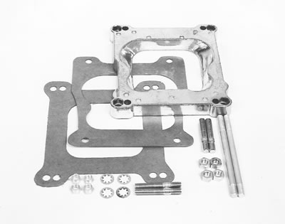

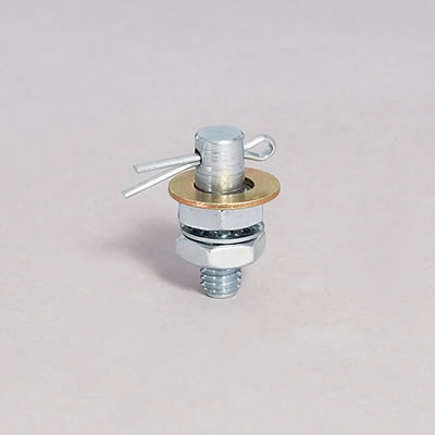

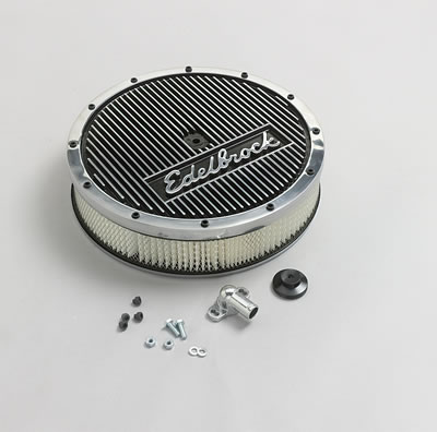

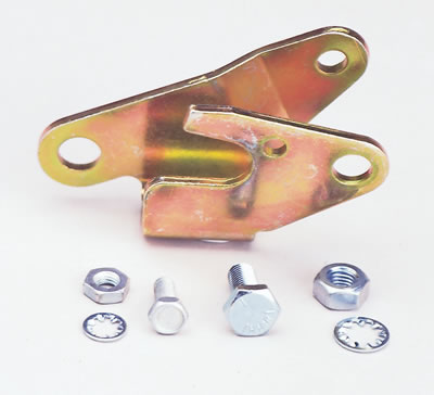

I'm gonna run the stock intake. What all do I need?

You will need the following.....
http://www.summitracing.com/parts/edl-1481/media/images
I've talked to the Eddie techs in detail about this stuff. You need this to mount an Eddie carb on the stock manifold. You need a gasket on both sides of the adapter. Thick one goes on the carb side.
http://www.summitracing.com/parts/edl-2692/media/images
I needed this to hook up the cruise cable to the throttle adapter.....
http://www.summitracing.com/parts/edl-8009/media/images

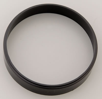

Depending on what air cleaner you use, I used an Eddie 14"x2" air cleaner and I needed an air cleaner spacer.
http://www.summitracing.com/parts/trd-2379/media/images
