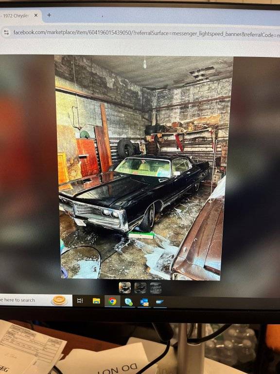

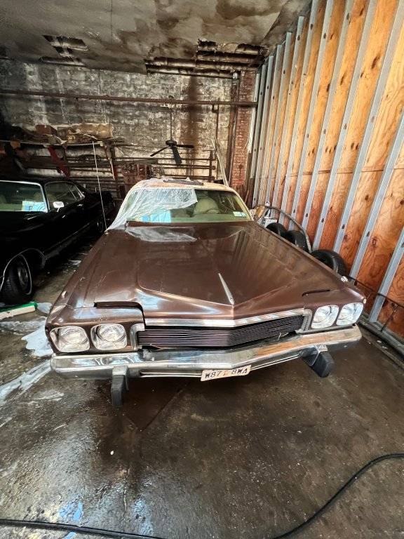

Good morning gents , just purchased a 72 Newyorker and a 73 fury . I had to grab them before some non C-body person got to them , They have been sitting for 25 years and of course no keys! My question is is that i have the original dealer invoices for these cars .The new yorker has the key codes on the invoice the fury does not. Can i get the keys cut for the New yorker cut from a lock smith with the codes? I have to get them on dollies just to get them on a flat bed without . The fury is eay to load but the newyorker is in the corner of the garage anf it would be a heck of alot easier if i could steer it out ! I have to move thses after the big snow we are having today and tomorrow so Tuesdays the day any advice would help. I have 4 c bodies so i dont know what im going to do with these .The newyorker is near mint only option is A/C has a 440 sure grip 99000 miles and is straight as an arrow . The fury has quarter rust and some dents and has a 360 with A/C . Im hauling these out of NYC . The C-body disease is alive and well in me!

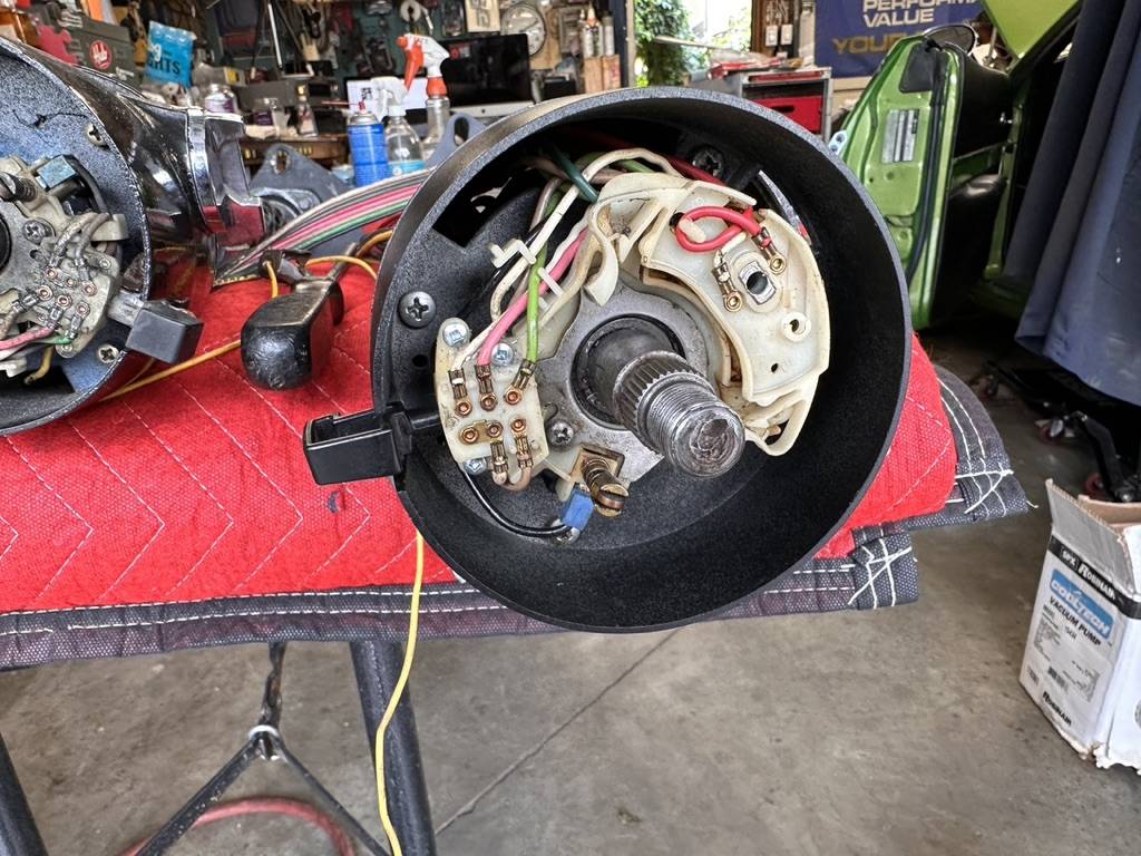

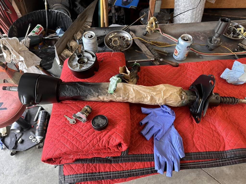

I've pulled the steering wheel and popped the lock out before so I could unlock the steering, easy and doesn't take long at all.
Not too difficult, some patients and tools, steering wheel puller, screw drivers, snap ring pliers, needle nose. etc.. These pics are from a 73 B-body, but should give you an idea.

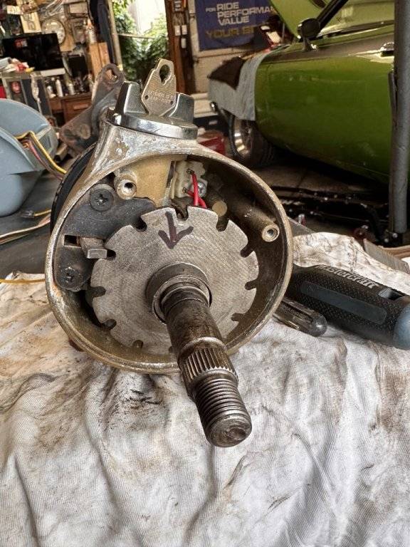

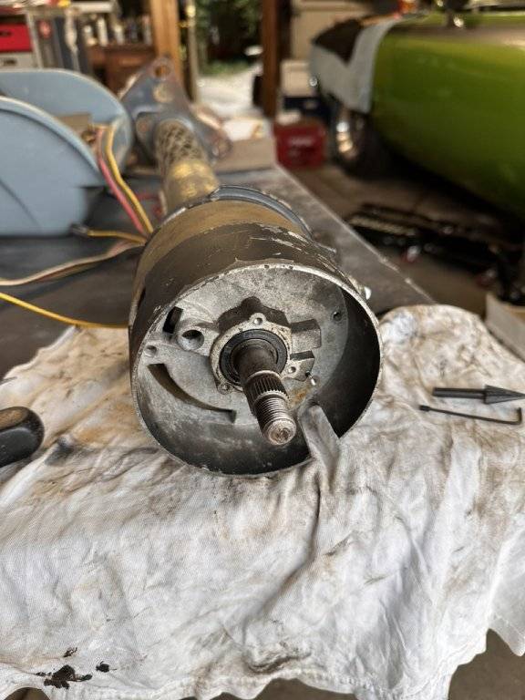

i have keys for the 72 how hard is it to pull the column cylinder?
I don't understand the need to pull the cylinder if you have the ignition key?
But, I yanked my 72 new Yorker with a slide hammer, slide the new cylinder and key right on in. Because I didn't want to mess with the column innards. It was a 15-minute job.
I drilled the slot to accept a large screw. It was an easy straight forward deal. A little screw that fit into the slot would not bite into the slot and hold for the pull for me. Then things need to be lined up to put the new cylinder in.
The slide hammer breaks off the little hidden security tab that you would press in to remove the lock cylinder. Be sure to retrieve the tiny broken off tab. The one that you would otherwise need to remove the wheel to get to so tab can be pressed for release.
I can be in there to undo the ignition lock ("key switch") in about 10 minutes without destroying the original. Pop the steering wheel off is the worst part of the whole thing
I've gone in when I had to. Turn signal, horn, cruise, old cracked wires. The usual stuff.
