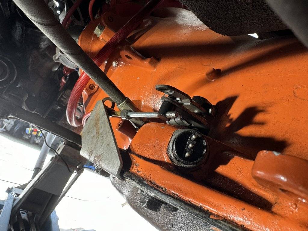

Got a strange problem here:
When installing a new B&M shifter + cable on my 727 TF, the transmissing only has 4 clicks moving the gear selector, when it suppose to have 5 right? 1-> 2 -> D -> N-> R -> P. Its not a cable or bracket issue, because when I remove the cable completly, and just have the gear selector bracket attached, i'm counting 4 clicks, instead of five....
The cable fits just fine. no matter from which point I start to adjust the cable: When I adjust the cable in low or first gear, it shifts all the way up the the R position. And if I start on P, it shifts flawlessly to second gear. But either way, it just misses a click - gear.... The gear selector bracket can be only installed in one position, so preventing movement just because the bracket got stuck or something, thats not the case.
Also, I'm not sure which gear position im missing now: is is the P or 1? Are there ways to determine that?
Any suggestions?
Its a 383 with a 727, there is no driveshaft attached as I recently did an engine swap to this 383.

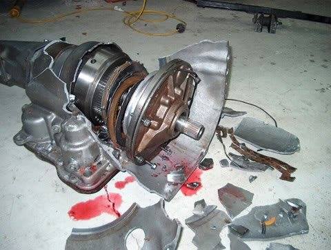

In a full manual valvebody with no low band apply function, this is true.
If the trans is still fully automatic, or it has a manual valvebody with low band apply, you start in 1, which applies the band in addition to the sprag and then shift to 2 and 3, if the combo has enough steam to maintain wheelspeed. The band helps hold the drum with sprag.
With an automatic valvebody, you under no circumstances want it to downshift back into 1. The band only applies in manual 1, so if it downshifts, only the sprag is holding the load. You release the brakes and roll out of the throttle at the same time so when the tires bite, there is no shock load on the sprag.
This is what happens when a sprag gets rolled.

Tried to rotate the transmission shaft while clicking the gear selector. Still 4 clicks....But at least now I know that im missing the P, because the shaft rotates freely on all selected gears. Now I'm only assuming this as the shaft won't rotate when in P right?
The park paw maybe frozen. The rod inside the trans that engages the park paw has a spring on it so you should still be able to move the external level into the park position unless something inside is assembled incorrectly. Push back fairly hard on the lever and see if it feels like a spring is pushing back.

Looking at the first post, there is a triangular shaped bracket which seems to be held in place by a couple pan bolts. That looks like a bracket on the trans on a '88 police cruiser I had years ago. the purpose of that bracket was to prevent selecting low gear ("1") position. I removed the bracket and the shifter worked normally. Lindsay
Yes, most police cars' TFs had a "Low Gear Blockout" on them. Would not go into manual Low/"1".
Reason? Normally, when you move from "P" to "D", that's as far as things go, BUT in the heat of the moment, the shift lever gets slammed (so to speak) into "1" by mistake. Then, you know what happens several seconds later . . . engine at WOT . . . chase over, or at least the transmission not upshifting alerts the driver that "Time to Shift!", dum-dum. Then, "Calm down! You're in a Mopar!". So, keeping the shift lever out of manual low (only) has its merits.
