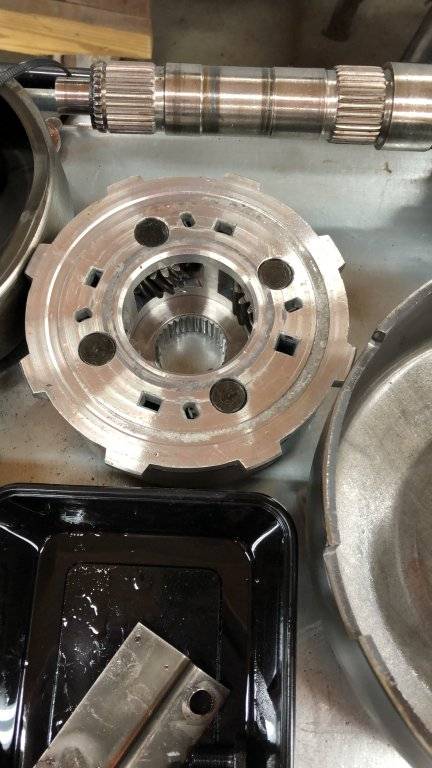

I was upgrading my 1965 727 from the small input shaft to the later design when I did the rebuild. I needed this in order to get a newer design torque converter because you really can't but the old ones anymore and I wanted to up the stall speed a bit. I searched for a low mileage motor home 727 or pickup trans and found a MH one with about 45K miles on it. from that I used the input shaft, pump, sprag and the heavier planetary gears. All of these parts were in great shape and save me a small fortune in part costs.
Here are the improved- 4 posts/4 gear vs original 3 post/3 gear planetary gears:

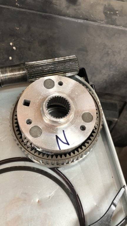

I am in the process off ordering parts for my A727 rebuild. This is a pre 1971 torqueflite. The photo below is the id # stamped on the case. The front four post planetarys are worn out. All the thrust bearings show significant wear, the four post planetarys being the worst. The tail shaft roller bearing is also heavily worn.
Question, who offers thrust bearings for sale. I have found many listings for 1971 and later applications, but none for 1970 and earlier. Will also need a front pump and a torque converter. My main interest is in quality parts.
