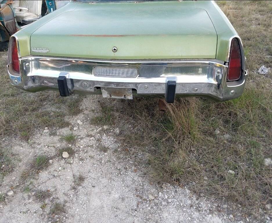

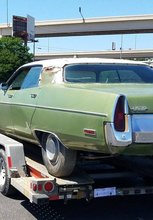

I'd be shocked if there was much if any frame damage. Sure looks like the hit was above the frame rails. There doesn't seem to be any movement on the door gaps and the exhaust runs inside the rear frame rail. It didn't clip the exhaust. Probably mostly quarter panel and trunk floor/rear pan damage. Worth looking into - checking frame and alignment/ride height of the back wheels first.

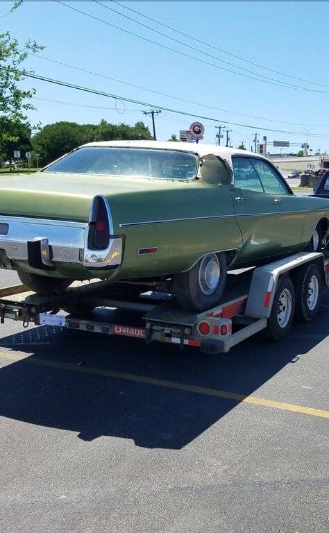

Both frame rails are bent. The right rail had to follow the quarter panel buckling and look at the door gap on the left rear door towards the bottom. The left rail has moved to the right.
