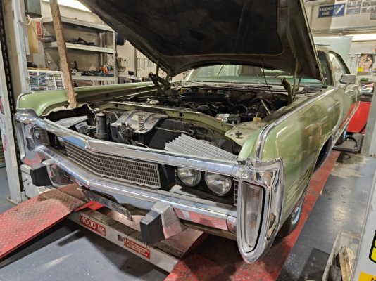

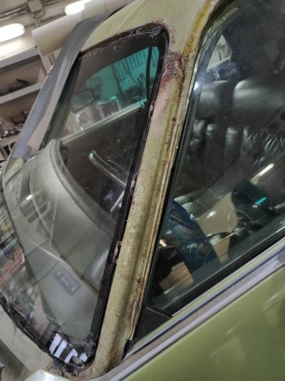

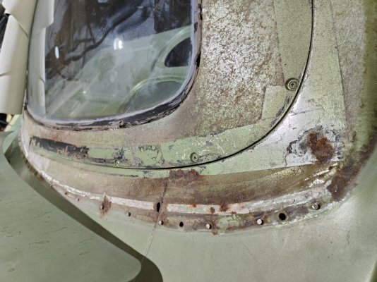

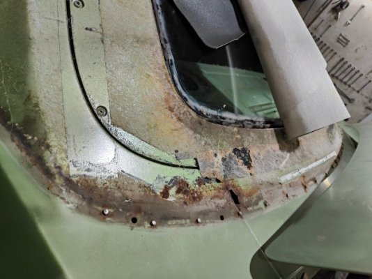

My 73 Imperial got scalped today - doesn´t look bad - only three rust spots, that can be repaired (removing rust incl. primer and paint), before the new vinyl roof will be attached.
For now, she is quite grumpy looking - "grumpy car" instead of "grumpy cat". ;)

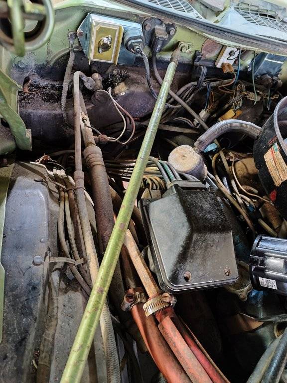

...but her Imperial highness refuses to start, after moving on the ramp by herself yesterday.
Ignition lock is new.

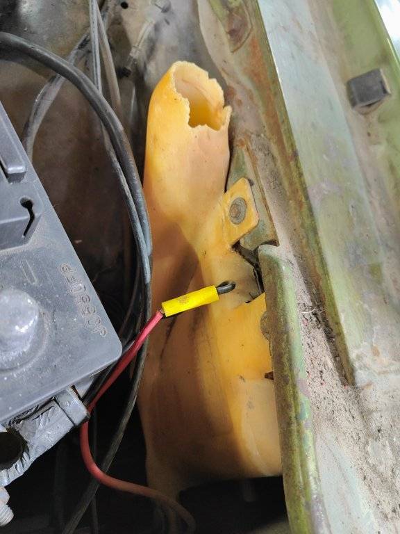

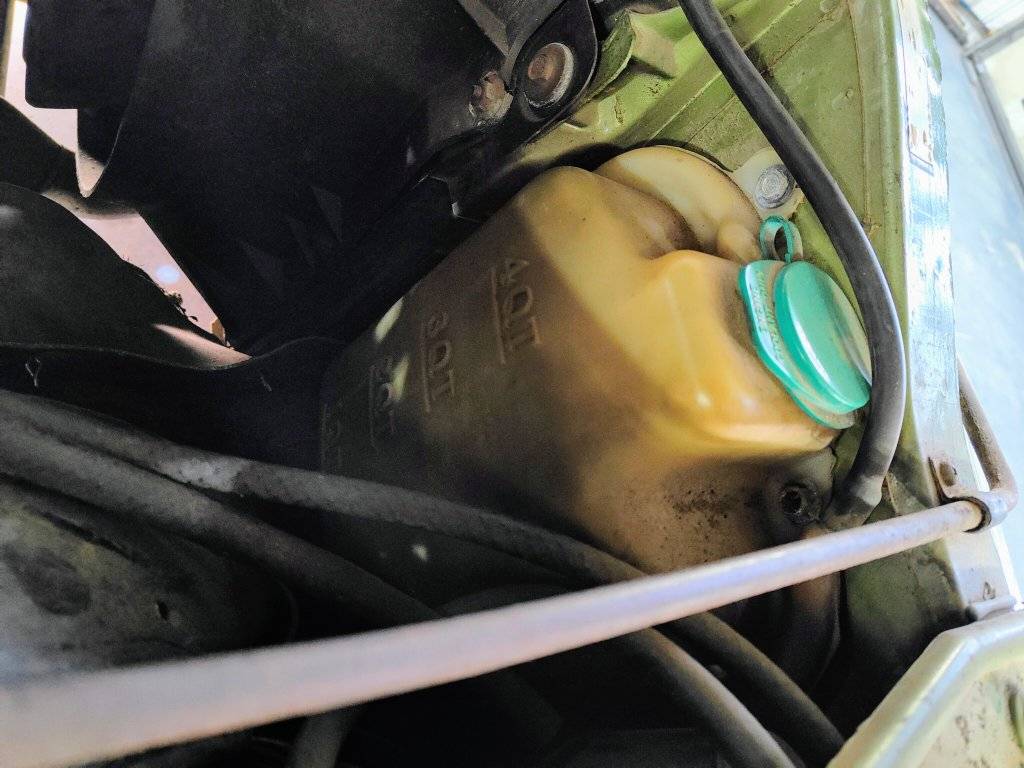

but the coolant bottle is complete, only the washer bottle is decapitated...
The washer bottle is the hard to find one, I presume?

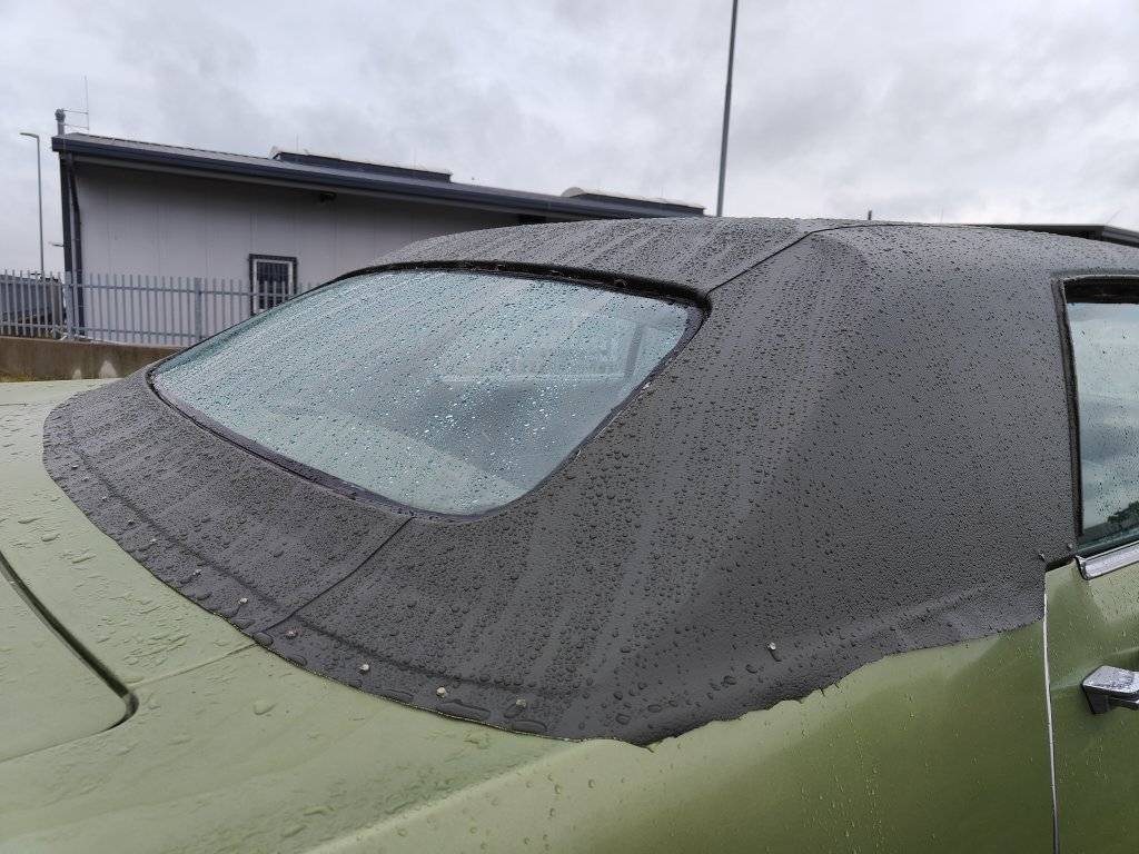

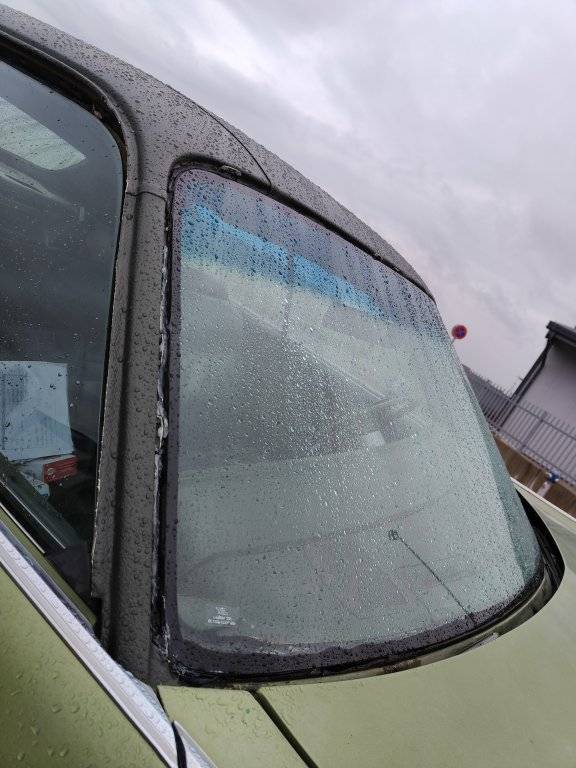

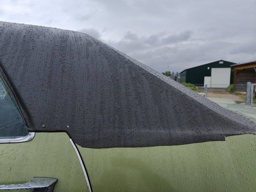

The Roof has been done meanwhile, after removing three bigger dents (where did they come from?) on the roof.
What faults were hid under others vinyl roofs of others?
Oh, there was a bit of rain before, when I took the photos.

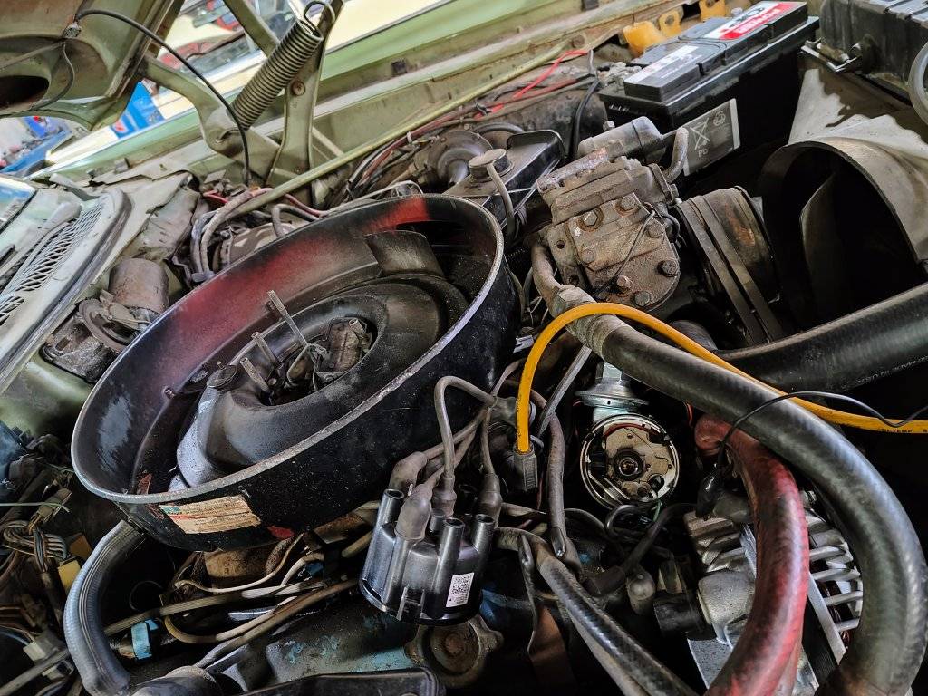

Motor is running - and starting - really fine now, after changing the carb for an Edelbrock 650.

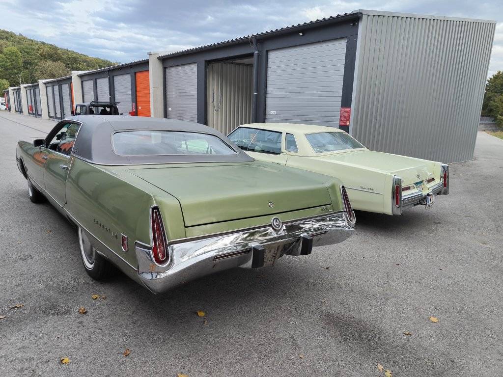

My Imperial is a model of 73, but the taillights are from the 72 model year and look quite nice, the car seems to never have had an accident.
Who would have changed the lights in the past 50 years - and why?
Or is it possible, that it was built in May 1973 with spare parts from 1972 - don´t think so - but who knows?
Should I change them - or leave them "as is"?
Some previous owner probably replaced the original '73 lights with '72 lights. Those are not parts that would be so-called "leftover parts" from an assembly line.

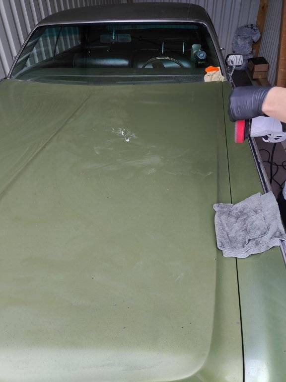

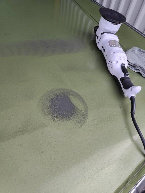

Now I polished the weathered hood with a friend in the meantime, as some fixes soon should be done by the workshop before winter storage. The trunk should follow in spring, as it is weathered even more.
The sides are still quite nice and should stay like that for some time.
Lots of lead (Pb) in that amber sherwood metallic!

Becarefull polishing single stage metallic paint. you may end up with stripes of clouds. This is a great write up of single stage paint restore.
[/URL]
Thanks a lot!
I didn´t do it myself, but a friend did, who has done some older single stage paints already. Hope he knows about that, if not, he can read that article over winter - I will send it to him.
But something had to be done.
Maybe in May, there will be some more single stage paint metallic action, when the technical issues with steering gear and unstable motor idle, which are still present right now, could be fixed.
But for now it doesn´t seem to have swirls and I am quite happy with the result.
