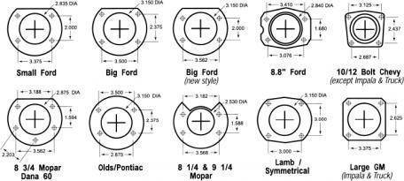

I must disagree, I did the swap from an Imperial 9 1/4" direct to my 8 3/4" Sport Fury housing directly...NO PROBLEMS...bolted up, no modifications at all. Everything fit. The only thing is the Imperial rear disc set up, it has one side facing forward and one facing to the rear. So if you dont get E-Brake cables from the Imperial, you will need two different lengths e-cables. All other stock components were used. The Imperial set up is very hard to find, they are out there, parts are available too. Calipers and pads are easy, remember to order two of the correct caliper, not a rt and left. They are the same caliper for both sides. By the way I used the 74 front disc brakes and spindles. They bolted in ball joint to ball joint. Remember that you will need an adjustable proportioning vallve for the brakes (front to rear) to prevent rear lock up.
