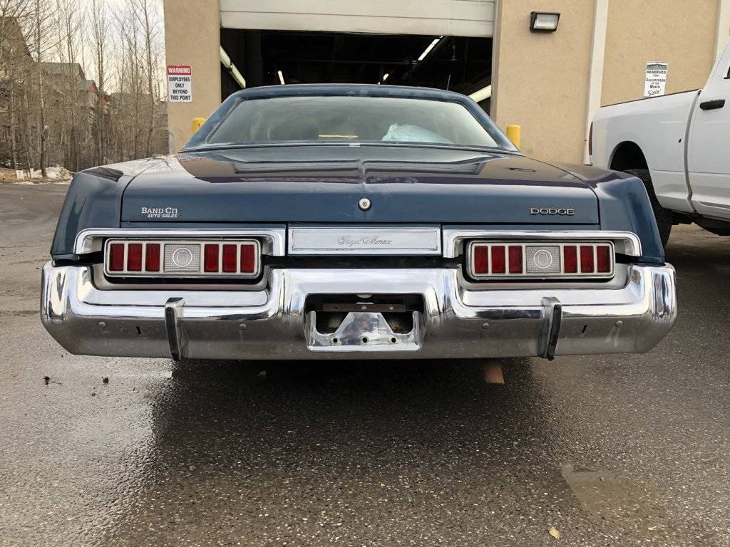

Well quick adjust of the floats and voila runs and drives!
View attachment 251434 View attachment 251435 View attachment 251436 View attachment 251437 View attachment 251438 View attachment 251439 View attachment 251440 View attachment 251441
Looking good! I wonder if the elevation change was enough to throw off the carb?
Are you another one that will tinker with that POS forever and a day in denial?Still has a part throttle stumble but I’ll get after that in a bit
Timing chain,Now I’m thinking I need to do the timing chain after reading Peter Clancy’s post
Nope I have no patience for non working parts. I had my finger on the trigger today buying a rebuild TQuad from Rockauto and I still might. I really don’t want to mess around with the originality by putting on an Eddy but it may come to that yet. Now I’m thinking I need to do the timing chain after reading Peter Clancy’s post
Actually, I have had very good results with the Autoline brand of remanufactured carburetors. They are very tuned into warpage problems with some of the Holley and TQ carburetors and seem to know how to rebuild them successfully. I have called them in the past to discuss the steps they take to deal with the warpage and they are thorough. Rock Auto has the Autoline brand TQ for your car too. So I would have some confidence in buying one from them. None of the other rebuilders out there seem to have their degree of success in my experience. I did have an issue with one of their rebuilt 2 bbl Holleys once, but they stepped right up and supplied me with a second one that was perfect. So their customer care is exemplary.
And, I have been less than impressed with the Edelbrock line of carbs lately since they don't seem very strong off the line and have hesitation problems right out of the box new. And I am like you, as I like to keep them original. TQs can run really well in my experience over many years when set up properly.
