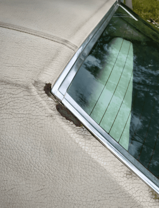

How does one remove the stainless trim around rear and front windows? The service manual does have some minimal instructions for removing the trim from the A-post but that's it. I've watched some videos of various cars but not specifically for this car and as I try and work on the piece it doesn't want to release and I don't want to force it and bend it.

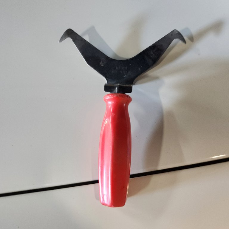

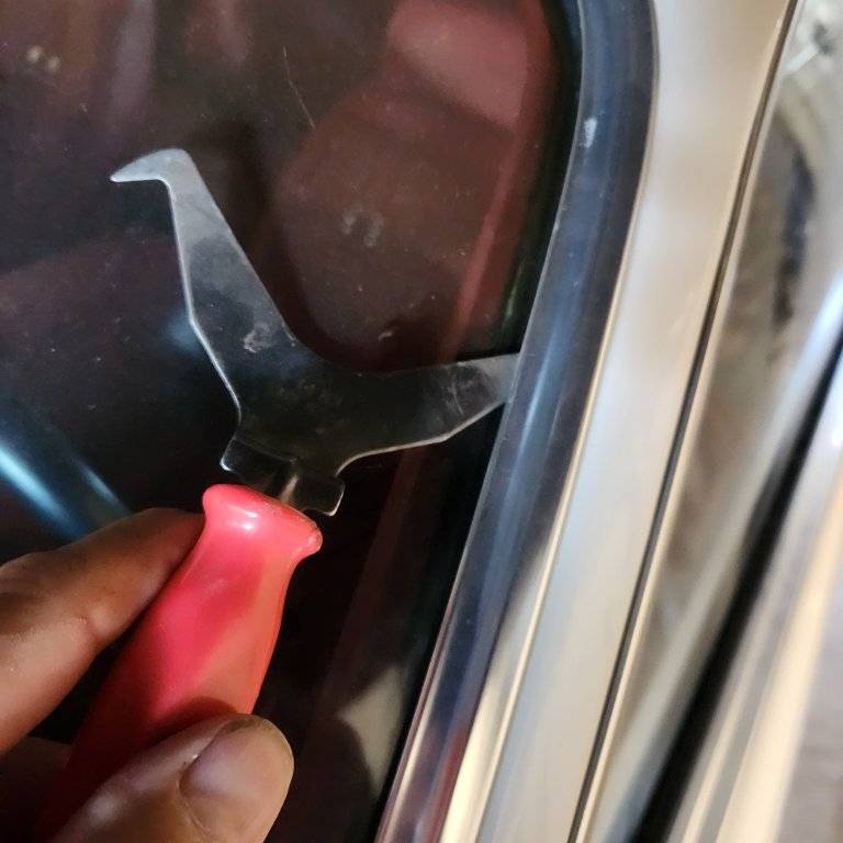

Ahhh! So it seems the one video that I watched was on to something. They used a 90-degree angled pick. I have one of those and tried to use it, but couldn't feel it "catch" anything. But I'll keep trying. In fact, I might just make something like this out of a piece of thick sheet metal I have lying around.
Thanks for the pictures!!!
