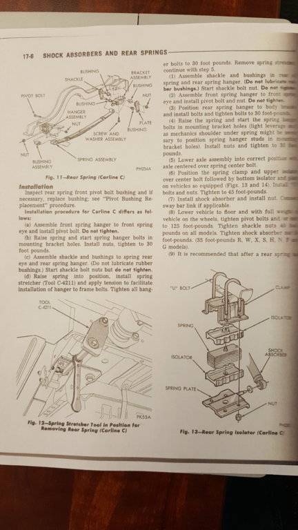

Went to the FSM and the procedure is to use a special tool to pull the rear spring hanger into place. I scanned the appropiate page. I think i can make a similar tool from a piece of 3/8 allthread, some 1/4 bar stock and weld a short piece of 1/4 or 1/2 pipe to the allthread, and either run a bolt through the pipe or weld nuts on the ends of the pipe and either use a long bolt through the holes in the hanger or short bolts screwed into the captured bolts in the pipe. A morning's work once I get some materials.

Here is the page out of the FSM
Ok, so the tool bolts to the bumper shock, not the mystery bracket. At least my memory was pretty good at needing a special tool, since it was around 1983 that I read through the '78 service manual.
Yes, the bracket was meant to be shipping tie down.
