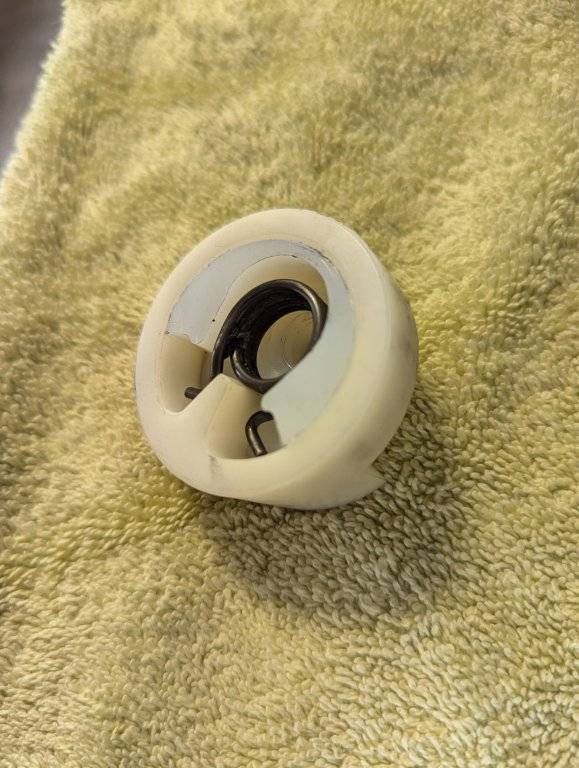

Okay - Thanks for the heads up. Do you know how many parts made up the intermittent cam? Is it just the outside white ring and the brown insert, or is there something hiding under the brown insert?
FYI - If I could ahold of a drawing of the cam or a physical cam that is intact enough to create a rough scan that I can then clean up in Autocad, I can get them 3 d printed. But no luck on finding either.
I have an undamaged outside white ring, so I really just need the brown insert.
Also, would you happen to have the part number for the cam?
Thanks!
Jeff

sorry no idea of the part #, gotta find some one with a parts # book or try going to the dealership. theres still dealers that have kept the info.
i used to have an nos cam but it blew apart within a month of it being installed, dont have any intact 1s around
Just my 2 cents.. search for wiper cam repair. Very extensive threads on different techniques.. mainly welding couple different pieces to create a solid unit..

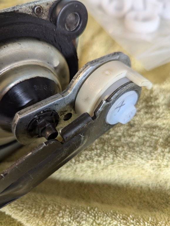

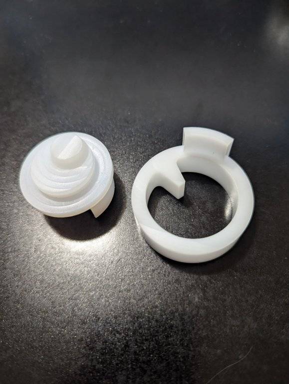

I have the proper cams for the 78 New Yorkers. They are machined on a CNC machine. They are a much better material and thicker than the originals. Email is marv.gingrich@gmail.com if you still need some.
