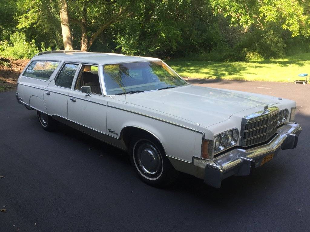

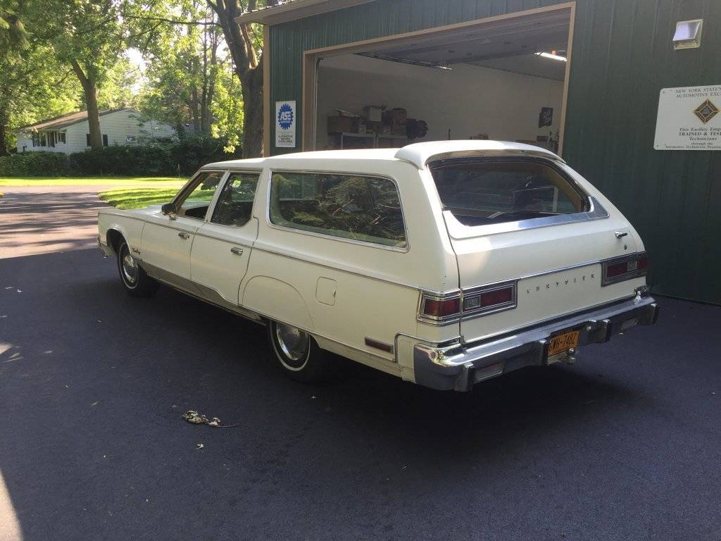

I got the parts car, but it has no roof rack! This is another rust free west coast car. I know the full history, but no third seat and no roof rack so I found a better one - the yellow one. For now it will donate missing trim etc...
Good call getting a parts car, although that white one looks too good for that.

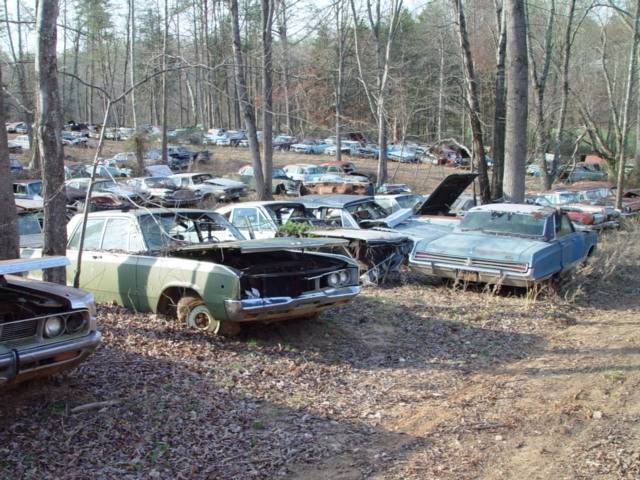

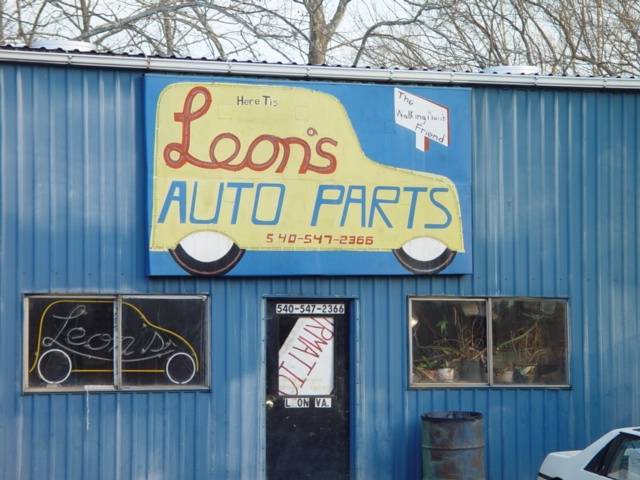

Leon's Junkyard in Culpepper, Va.
Be on on the lookout for wasps, snakes, and people playing banjo's....
Read the rules carefully...
If you get there late....you aren't getting in. If you don't get out in time....you are locked in the yard 1-2 hours for lunch. Only walk-in allowed...no vehicles. And there are constant and humongous hills throughout the yard. They will provide lift for major components....extra cost.

That is part of what I need off this. Rear bumper, various trim pieces, both mirrors, rear letters. Who knows what else. The white one was parked in '85 with 70K on it. Sat beside a garage in Montrose CO since then. Not a heavily optioned car, it was used to chauffeur realty clients around.

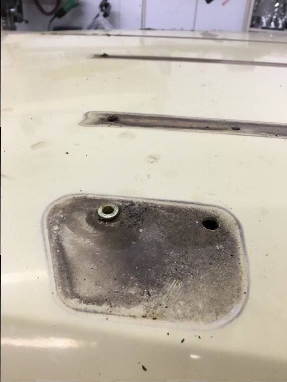

For the record, the screws did come out, but I wouldn't say they go into anything solid. They appear to be mounted with the equivalent of drywall anchors. Most of them stayed in. Shouldn't be too bad to reinstall.
Or threaded pop rivets like I mentioned earlier. I had the tool for installing both 1/4"X20 and 3/8"X20 'til I gave it to a Car-Bud when I moved south. Jeep iz-waz still hanging the rear gate tire racks with the 3/8"X20 size
I'm not that worried about the roof rack. You gave me enough courage to take it off.

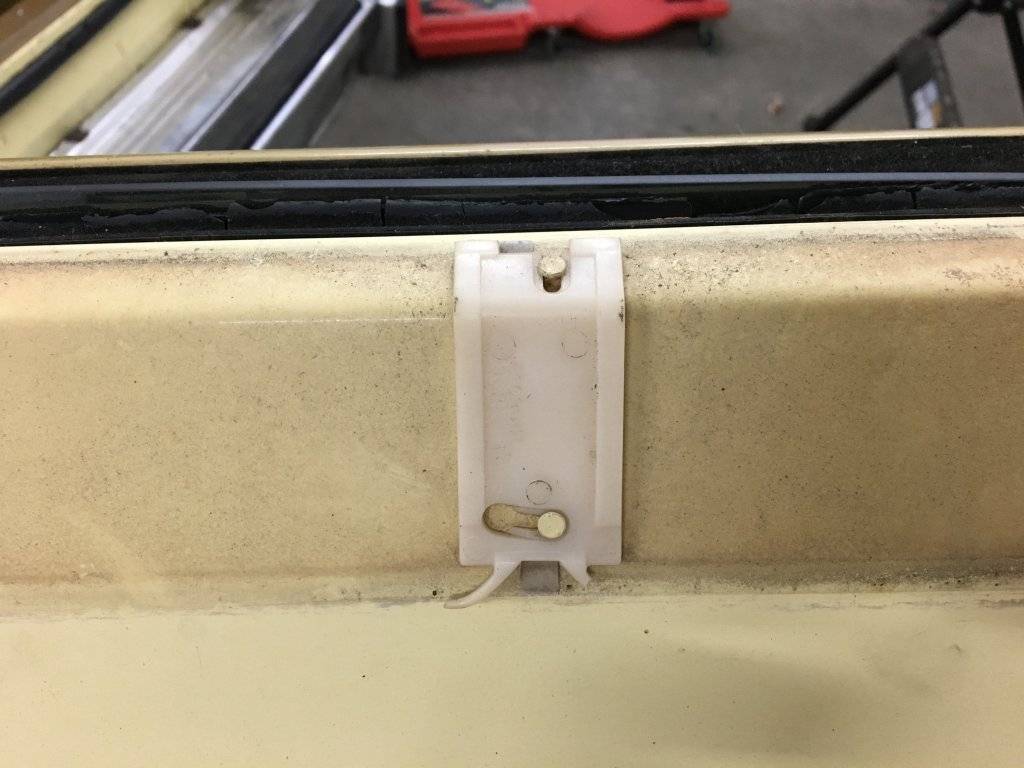

The plugs largely stayed and they are tight. Now, the clips for the rear door upper trim are a different story. I am guessing these are not just lying around at NAPA...
I'm not that worried about the roof rack. You gave me enough courage to take it off. View attachment 109272 The plugs largely stayed and they are tight. Now, the clips for the rear door upper trim are a different story. I am guessing these are not just lying around at NAPA...
I spent years searching for that same style trim clip.
Yep. You're right. Unobtanium new.
Did you need it for a wagon or was that part used elsewhere? Sometimes helps to know when your looking for parts to know what they come off of.
The same style was used for the rocker panel moldingson all the Formals, only without the bend at the top yours has. In fact I thought it was the same one until I noticed yours had that bend.
I looked at literally a gazillion of them out there. Aftermarket, repops, NOS, you name it. Zip...
But that was several years ago. Maybe your search will come up with something.
Those damn flimsy little tangs get brittle and snap just looking at them.
That bend makes them wagon only. Preserve the tangs you have left as best you can, because you have to re-use them.
