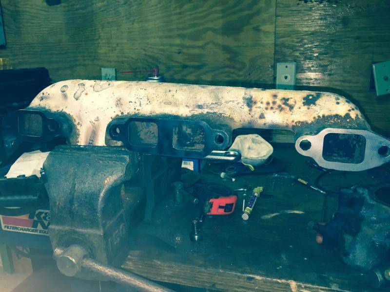

Well after spending half a day installing manifold studs ,cleaning the manifold mating surfaces and trolling on the Cbody forum, I don't think I need to use gaskets on them. The heads are in very nice shape and the manifolds mating surfaces are really nice too. I've noticed a split between those of you that do use and those that don't. The FSM says "none required". And I'm keeping that " dirty white" coating on them. For some reason it fits well with the rest of car.
