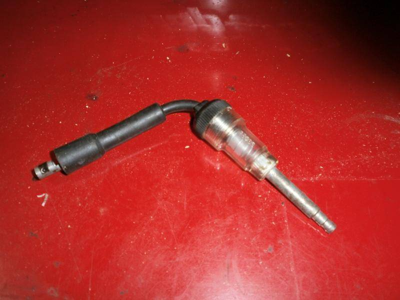

PC240002.jpgcheap spark testers like this are $5 and are safe and easy to use... blinky light makes it very clear you have spark.
