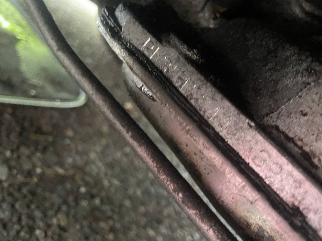

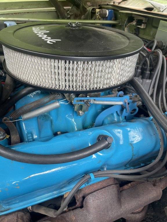

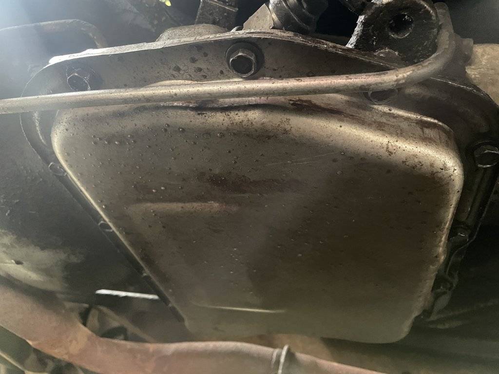

I swapped a ld340 4 barrel on it toIs it a factory 360 car? I'm pretty sure they didn't put 904's behind 360s in C Bodies till 74 I think. And then they were the HD 999 trans. Get the PK part number off of the pan rail right under the shift linkage and post it here. If if would be the 999, I would rebuild what you have. There wasn't a 4 bbl swap on the 360-was there? Post some pictures of your kickdown linkage and throttle bracket. I have the 999 part numbers.
