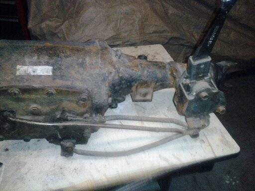

First of all, a good picture of it will get us 95% of the way there to knowing what it's from.
After the picture, the last 5% becomes moot anyway.
What do you want to stick it into by the way?
Post a pic please and welcome to FCBO.

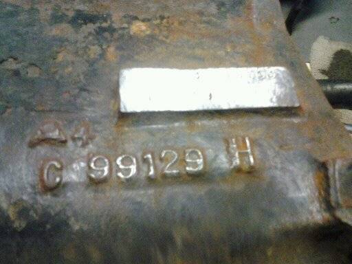

8B375XXX is the partial vin of the car and the only thing that tells you is it's a '68 Hamtramck built car. The other numbers you have there are incomplete as well but its a series that basically denotes what you already know, that its an A-833 and there appears to be as many as 5 numbers missing, 4 of them being the date code. You will never be able to tell what it came out of exactly, the best you can do is find out what model line was being built at the Hamtramck plant in '68 and I think the answer to that is B-bodies.

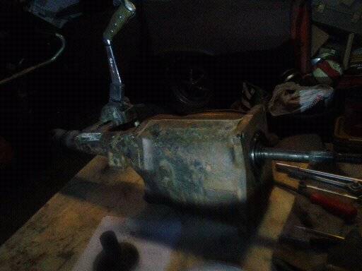

I ain't seeing any pic yet...

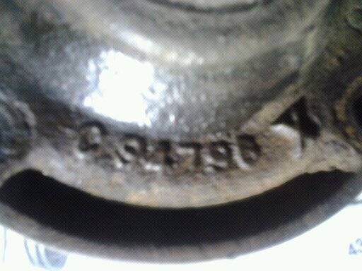

And somewhere on the case there HAS to be a seven digit casting number beginning with the number "2".
But it's a moot point. The case could have bee used on anything.
If you measure the Bearing Retainer Diameter, it should be 4.35" and that will confirm it.
See? A picture is worth a thousand words.

At this point, the bearing retainer casting number is the important thing to identify your internals in case of a rebuild.
