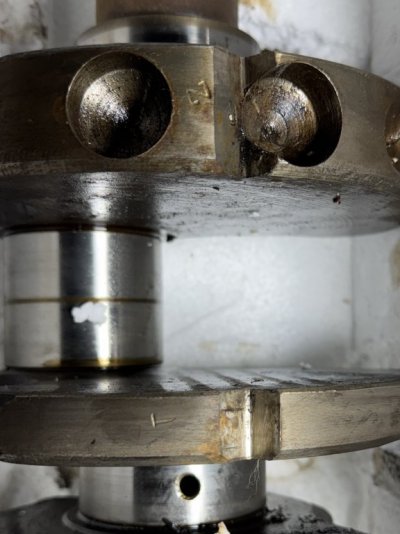

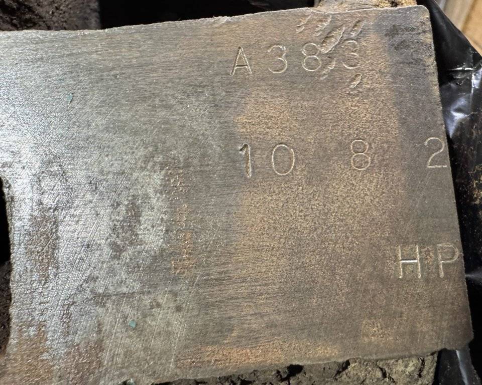

First question is about crank markings. The first photo shows my engine ID boss. It doesn't show anything about non-stock bearing sizes such as a cross or diamond.

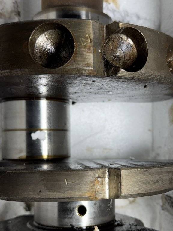

But on the crank counterweights, there are markings.
A 'Z' and what appears to be T. These are the counterweights on either side of the #1 and 2 rods.

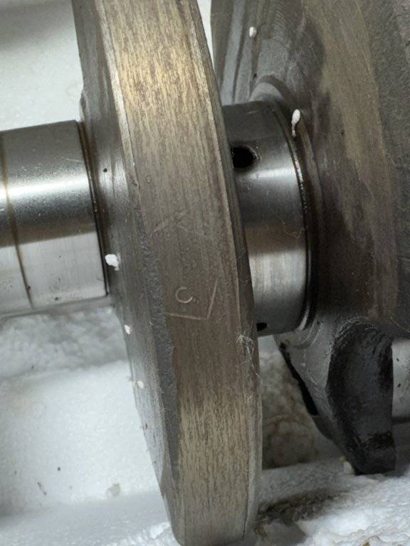

Then there is this marking...
The letter C framed by half a square.

I really don’t think any markings on the crank mean anything to anybody post original assembly.
A couple things I've read about those markings are that they use them to identify standard or undersize journals. One being for mains and one for rods etc.
I would bet the C in the diamond is an inspection stamp.
The markings on the ID pad, as listed in the FSM, are there to ID when a production block needs a few "touches-up" so it can be used rather than scrapped. Which could be important as to warranty repairs and such. Past that, nothing supported by the aftermarket per se. As some of those items would only be found in the factory parts book, as to sizes.
As to the crank stamps and such, they might reflect not only sizing but also the "balance" as it spins on its balance checker at the engine plant. If a certain imbalance might exist on some counterweights, then the noted connecting rods' weights can be adjusted accordingly. Again, only things which exist at the engine plant. Easier to have some connecting rods already "touched", ready for installation, rather than try to "touch" the balance weights on the crank, by observation, to get the same end result. This is why all OEM connecting rods have "balance pads" on them AND why my late machine shop operative would order a factory-matched set of rods for rebuilds (from his brother that was in the engine core business).
When the engine is rebuilt, with new pistons which are generally a bit heavier than OEM production over-sized pistons, there are balance pads near the pin boss on the piston's underside. Plus balance pads on the connecting rods. When those weights are equalized to specs, then the crankshaft is balanced as the final part of the puzzle. With the weight coming from the counterweights.
IF the crankshaft counterweights are "knife-edged" or rounded (David Vizard YT vid on this), then balance is also affected and those other balance pads (pistons and rods) can become much more operative, as to changes. Which can make a normal balance job much more intense.
Hope this might help,
CBODY67
Thanks to all of you for your reply. I have the Moparts site bookmarked, but the markings I see didn't have any reference. And I had heard, as Big_John said, that sometimes the bearing sizes were on the counterweights. My measurements verify that they are stock, so as DetMatt & CBODY67 thought, the markings are probably just manufacturing indicators for processing.
Thanks again.
