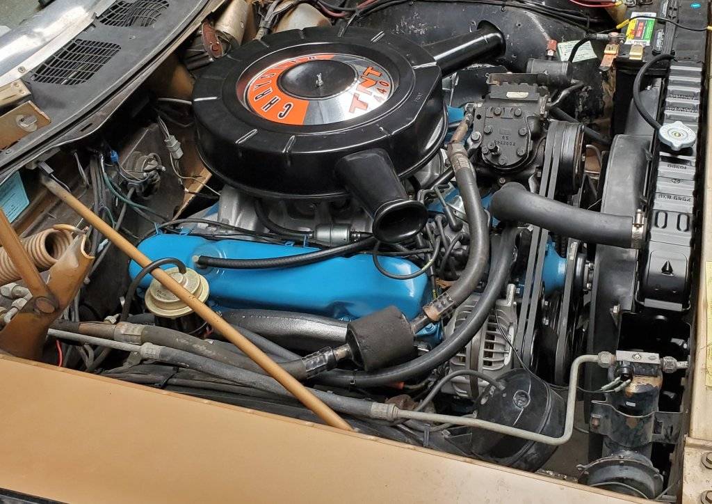

Does the A/C compressor have an RPM limit?
69 Chrysler 300 with functioning OEM A/C (R134) until recently. Just started to trouble shoot, but one of the changes I recently made was changing the transmission shift point from the stock 4000rpm to 5000rpm to better align with the cam/engine rebuild. Did I inadvertently cause a new problem? TIA

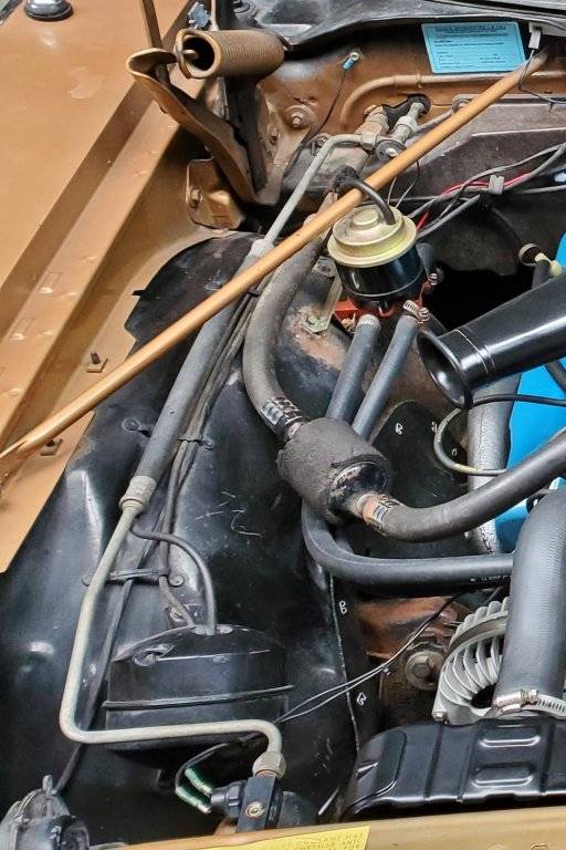

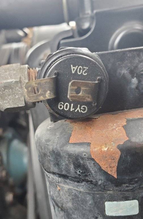

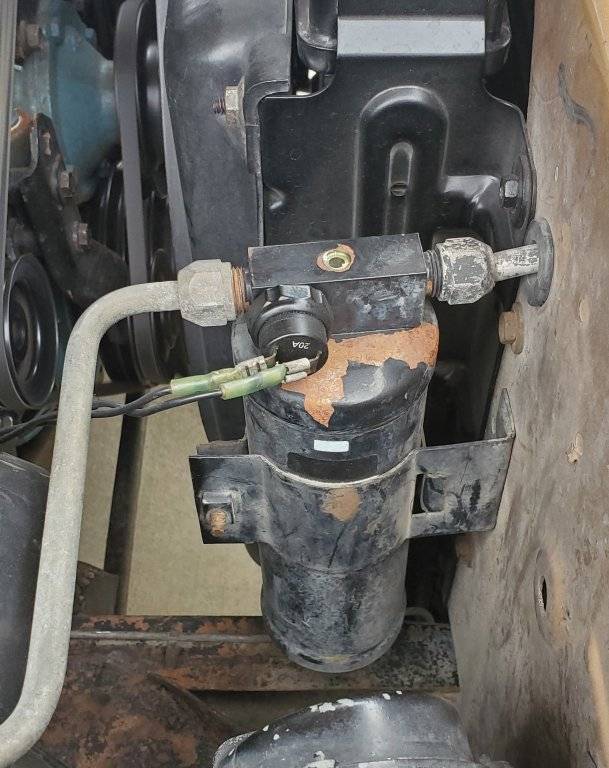

I have 12v to the low pressure switch, but not out. (Was this switch added/required for the R134 conversion?) I know it's not OEM.
I don't have the tools/gauges required to work on the A/C so I will need to take it to my buddy's house for further diagnosis.
I was just trying to understand that if the leak IS from the compressor could the 5k rpm have been the culprit.
Thanks for the help.
That low pressure switch on the receiver-drier was just that, a switch to kill power to the compressor clutch if the gas charge in the system got too low. Somebody might have replaced it with a cycling switch when they did the R134a swap?
There was never an rpm limit for the rv2 compressor, they are very indestructible.
If there is a problem with an rv2 compressor after being rev'd up there is a problem with that particular unit. If the belts are coming off at rpm when the clutch cycles there is alignment - installation - hardware issues - period.
Cop cars had a pressure switch inline with the power feed for the a/c clutch that attached into the high side of the ac system on the compressor to protect the compressor
It's in the parts books.

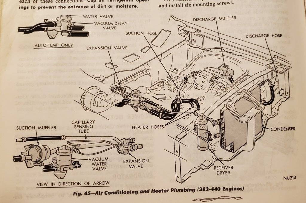

Thanks for that clarification. As I recall, prior to about the 1969 Fuselage cars, there was not a low-pressure cut-off switch should refrigerant get low. Such determinations were made when the system did not cool as well as it should, not by switches. On our '66 Newport Town Sedan, when the cooling got a lit "warm", that meant it was 1lb low on R12, so it got recharged for another year. These were ALL systems which used the EPR-type valve to modulate compressor operation, as the compressors ran all of the time, unlike the cycling A-body and aftermarket systems.
Remember, too, that on the earlier (1950s-era) Chrysler a/c systems, the a/c compressors had no cut-off switches. The compressors had no magnetic clutch on their pulleys, so if the belts were on the compressor pulley, the compressor was running. So it was not uncommon for owners to remove the belts in the "off season".
