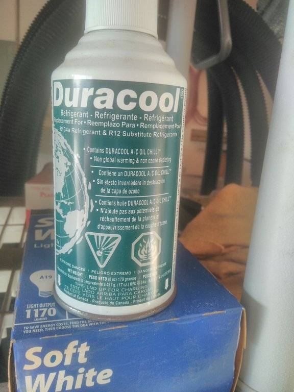

You guys are referring to this stuff. It's actually called 12a. Hard to find as it is illegal in some states.
Anybody want to buy four cans of this stuff? Don't need it anymore.
