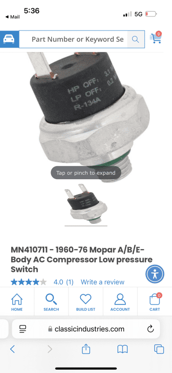

Problem solved and A/C works. After doing a lot of reading and not clearly seeing a specific reason for the symptoms I decided to at least replace the a/c compressor low pressure cut off switch and drier before tackling behind the dash. When I was shopping for the switch Classic Industries (car parts) web site noted two important things; one being that the switch is actually low pressure and high pressure cut off switch and more importantly when moving to R134 you must use a cutoff switch that is designed for the new refrigerant or the A/C will not work! I did not see this specific piece of information noted anywhere else.
Yes, the cut of switch was original and meant for R12. This is the new switch and also works with the c body.
R134A has higher working pressures. There are a few ways to get around too high of a pressure. Several were requirement of doing the conversion. One was to use 80% system charge. Next was to ensure continuous airflow across the condenser, so most would add an electric fan-more air=lower pressure and better performance, or replace the fan clutch with a HD unit. And the third was to add a switch in the high side to shut off the compressor if the pressure climbs too high in situations that the air flow is not correct across the condenser to prevent damaging the compressor. Some diagnosis can be done just using your hands (caution of moving parts, and the high side parts could be VERY hot). From the compressor to the condenser will be the hottest. All the condenser should feel pretty warm as well-the hotter the day the hotter it will be. From the condenser to the firewall (expansion valve) should also be warm (never cold), and this includes the dryer. From the expansion valve back to the compressor should feel cold as this is the low pressure (temp) side of the system. If it is cold between the dryer and the expansion valve, that indicates a restriction in the dryer (Dryer has descant, a filter and acts like a storage unit for refrigerant). The "site glass" could have bubbles in it with 134A, so don't use it to determine system charge. If all the tubes and hoses feel correct but the air is still warm inside the car, then it could be the blend air door (temperature select lever) in the dash, or as was pointed out previously, the water shut off valve. Just sharing system information, that hopefully will help others.
