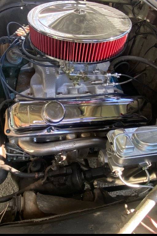

I kept my 383 added an edelbrock, holli 650cfm 4bbl and headman headers. Dual exhaust
Sound incredible looks great. Goes when I want it to but mostly I use it to cruise around and make heads turn.
