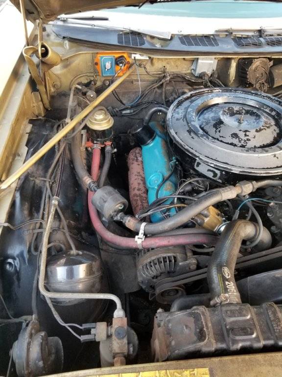

I was thinking of what I can do next now that I have the car back to ground zero mechanically. I was thinking of cleaning up the engine bay by first restoring the air cleaner lid since it is the biggest eye catcher. Much of the original paint flaked away as seen in the picture. Should I use paint stripper or have it sand blasted? Rattle can black or powder coat? Pros and cons of each method?
If you do decide to sand blast and rattle can it, or any other black stuff under the hood such as the inner fenders, remember to use a satin finish not flat or gloss.
