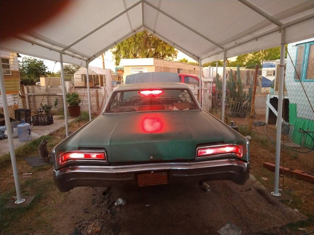

BTW, I plan to put that third brake light in up near the top of the rear window after I finish the exhaust job I've got going today. With the help of angels, I'm making this demo-derby escapee safe.

They do alright. Mine is located inside, up at the top of the rear window on little L brackets. I wired it off the left turn/brake light, so when making a left turn, it flashes along w the tail light. Otherwise, it works with the brakes. I don't feed it from the normal tail light circuit at all, so it ONLY shows when it needs to signal a change in velocity. I'm very pleased with this $25 investment. Next up will be amber LED strip on 1/4 panel molding right under turn signals, to show from the side. A '66 has NO side markers unless its a 300, and not much even for those tail lights.

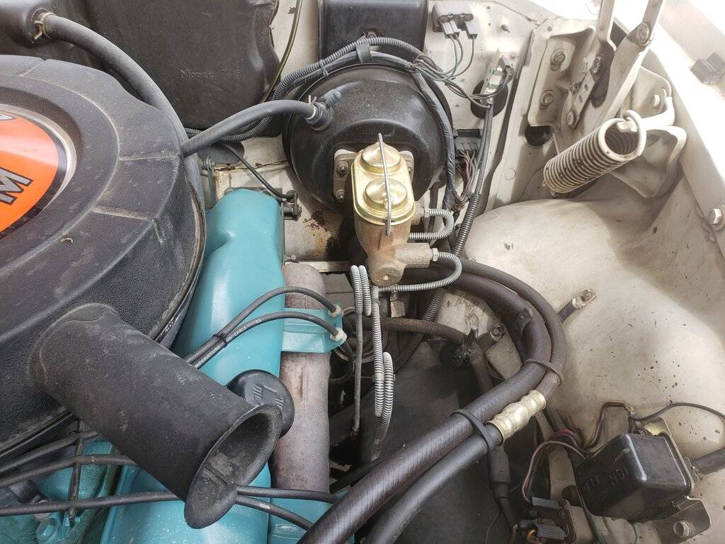

Did you do a moderate speed brake speed test to make sure that the system is properly balanced?
I did exactly what you did back in 2014 and found that the rears locked up under hard braking...
Found a distribution block from a 67 dual system and my issue was gone...
FWIW, YES, OF COURSE I tested the system after getting it together, then bleeding the lines heavily. It did alright, though I bled it again later that week. I've been running the new MC now over 2 months satisfactorily. It doesn't throw any harder than the old single pot cylinder, but it certainly doesn't do worse, is clean and new, with new synthetic DOT 3 fluid now in the lines. If I'd had more time to totally replace everything, I would have gone to DOT 5, but one picks the battles one can win....

This is the way I set up the brakes on my '66 Fury and after 29 years, zero problems. I've been using the silicone fluid all this time. The thing I also like about this is that most people don't even notice it is not factory! I thought I was the only one left who prefered drum brakes!

I basically did the same thing, I would have to look up the part # for the master cylinder. It was a 67 Chrysler if I remember correctly. Have had this setup for years with no problem with drums all all-round on my 64 880 wagon.

As far as brake lights go, take a look at mine, which are all red LEDs now....
