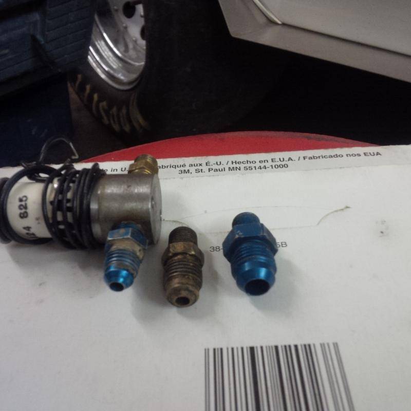

A727 transmission line fittin
You guys don't know WTF I'm talking about, do you?
Tis a tragic day now that I must knock on the door of Tech Support over at Moparts... :poke:
I believe its a dash 5. I was looking for one, and their tech said they can get something,, so I walked in an old school auto parts place and just found the proper brass one in the bins. it was 2 bucks.
-4 4/16 -5 5/16 -6 6/16
Thank you Rem. I understand you, others might not.
-AN4 = 4/16ths = 1/4"
-AN5 = 5/16ths = 5/16"
-AN6 = 6/16ths = 3/8"
-ANx = 37° Flare fitting which is correct for the factory transmission lines as opposed to the 45° Flare that you find at AutoZone, Home Depot, etc.
So, the next time Pablo asks, Can I help you....
And if the line is flared to 45° instead of 37°, I'll simply crank down on the nut until it flares into 37°. LOL!
Thanks Rem...
