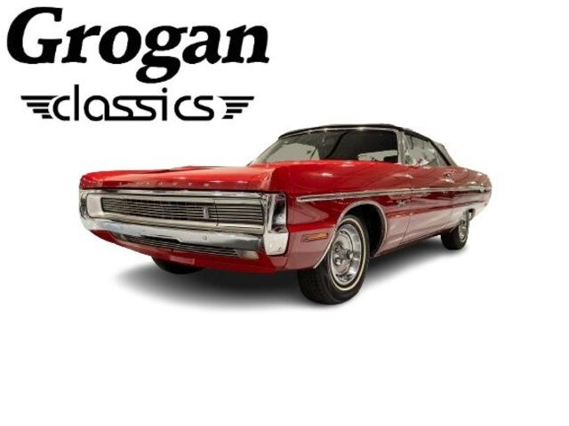

You wouldn't happen to be looking at this car maybe?
This one changed hands a couple years ago:
