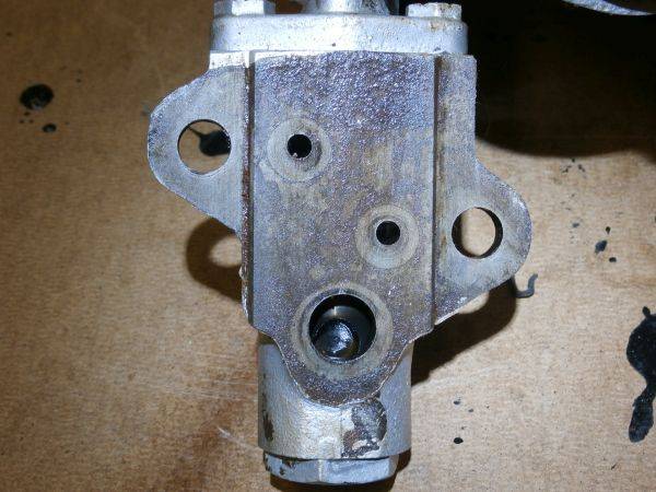

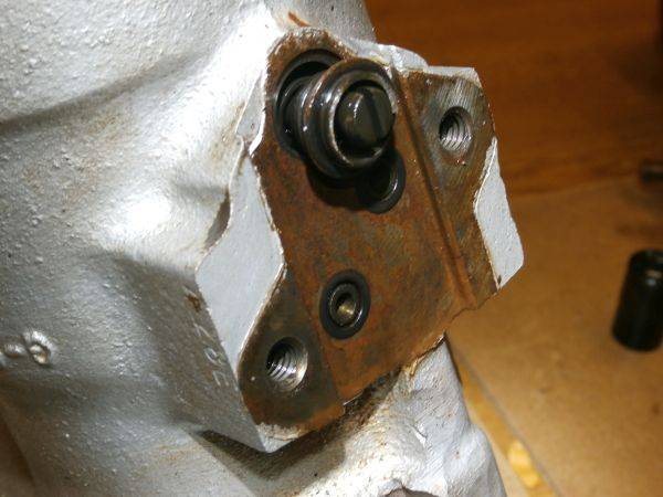

I don't think you can pull the spool valve out of the valve body while the body is still bolted to the gear:
The pivot lever will prevent it. The spool valve can be seen through the hole in the second photo. I did take the spool out, after taking the entire valve body off, by removing the outlet housing (the 2 small bolts at the top). I recall things being pretty clean in there, and the spool slides easily even though you can tell it's a close fit.
The PS gear is the one mechanism that you can watch all the theory video's and slide-shows there are about it, and still not know what exactly is causing mine or your particular problem.
Everything depends on fluid that must flow through ports and channels and not be blocked and seals that must seal.
I had a look at a few more PS-gear videos that I did not see before. It seems to me that most of the (Chrysler) tear-down re-assemble video's end without you seeing that the rebuilt gear actually working in the car. There are a lot, a lot more videos about the saginaw box, and it uses a completely different power control mechanism.
Here's a video that I did not see before, back when I was working on my gear:
I didn't solve my problem of squirrelly steering behavior with my original gear (the one shown in these photos). I think I didn't put in one of the reaction rings correctly. So I cheated and swapped in the gear that came bolted to the used stub that went into my Monaco and crossed my fingers. And I totally understand about the physical aspect of handing these units and yes they are an absolute bear to deal with.
What are you using for PS fluid? What did your shop say about that? I'm using ATF+4 and I think it works great. I think it's very important that the oil not froth. You absolutely have to get the air out and keep it out.
I think that any shop that claims to rebuild these things must have a working hydraulic pump setup and must be able to simulate these things working. There's a place here in London that I'm told can rebuild these units, I have it on the backburner in my mind to get in touch and have them R&R this gear, hand them the gasket and rebuild kits that I've acquired from rock, and pick their brains as to what is the secret sauce here. I think this is the place: brakesteeringrebuilders dot com.
Edit: I just watched that video to the end, and something important here: The alignment of the steering shaft to the gear box is important. The entire power steering operation relies on small changes to the forward or backward motion of the input worm shaft as the steering wheel is turned one way or the other. The worm shaft must be free to move forward and backward. I think it's the coupler that allows for this, but there must be room in the coupler for this, so ultimately it's the mounting of the steering column that will determine this.
