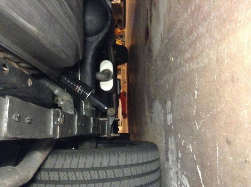

Just sharing what I did. I put new leaf springs in and did all new shocks. The only shocks I could find at the time were Monroe and the had coil springs on them. I thought it would be way too stiff but the car rides great. I had a bunch of people sit on the trunk and it didn't sag at all. I bet I could pull good size camper and she wouldn't drag. Hover I leave that to the ram lol. Yes my rear leaks and no the exhaust pipe doesn't hit.
