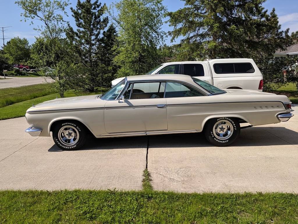

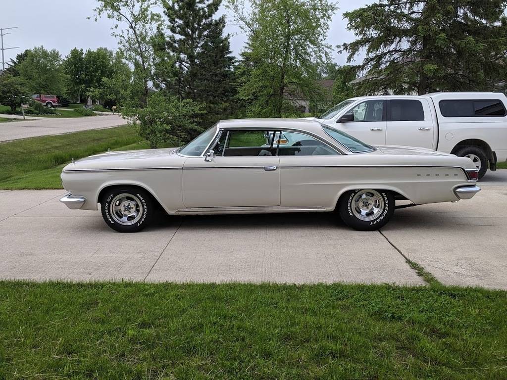

I bought the espo 7 leaf but with the 1 inch over stock. I enjoy the ride but did not like the rake that the car had so I put 2 inch lower blocks on it.

Gerald, what year / model is your car? Do you have any before and after pics?

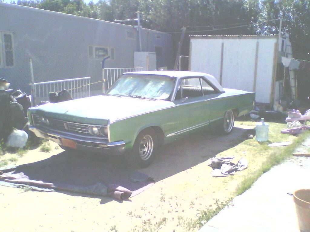

66 Newport, 2 door.
1st spring we had her, April 2016
