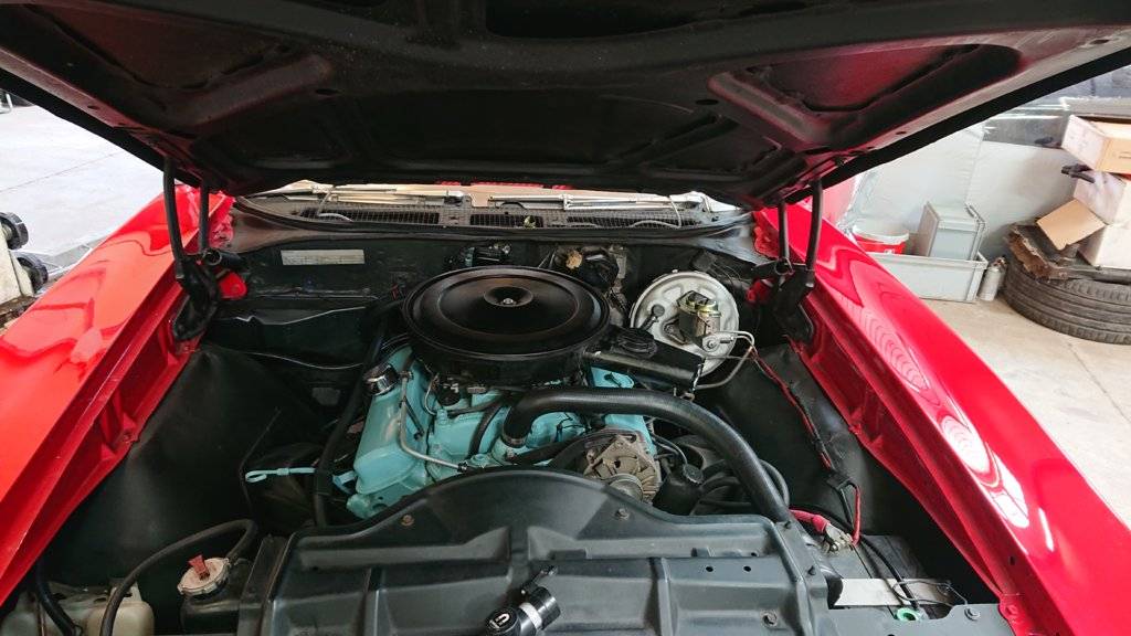

I went to that process today @Dsertdog and I had the same thoughts.. Will the snorkle limit the airflow and will have negative consequences for the mixture? Will there be a loss of performance?
Although with my 350cui Pontiac engine with a 1406 4bbl Edelbrock sitting on an Edelbrock intake and not with a Mopar engine.
I got rid of that standard chrome Edelbrock open filter element and put a correct 1968 4bbl GM single snorkle aircleaner on top.
Result..... Absolutely no changes! Engine starts when turning the key like it did before, it idles, accelerates and performes through all RPM stages as it did before!
Accelerates as it should to 70mph, leaves 20ft marks on the concrete and after all the speeding it idles smoothly through city traffic on a 85° day.
For spacing between air cleaner and carb I used Pro-Flo Series Round Air Cleaner Spacer (3/4") and the stock cleaner housing sits perfectly on that spacer
So my conclusion is, just give it a try, later Pontiac 455 H.O. engines had dual snorkels the Chrysler 440 engine was also sold with duals on the high performance models, why should a single snorkle limit a 383 that was designed to work with that set up anyways!
