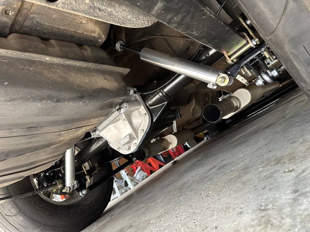

I have caltracs, split monos and Viking double adjustable shocks on my ‘68. The B body caltracs bolt right on because the Furies use the same length spring as a B body.
