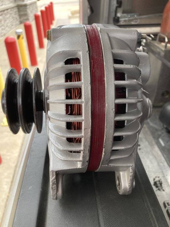

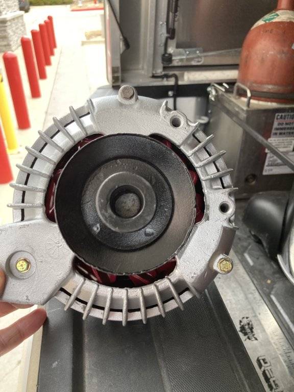

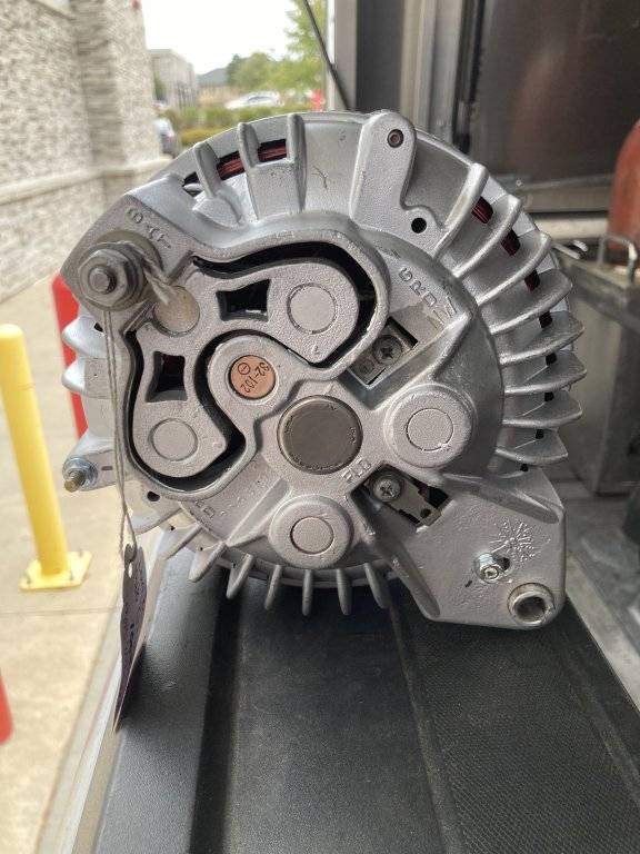

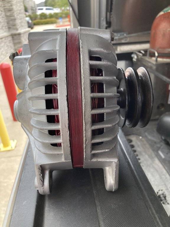

Just picked up my alternator from the shop. Total rebuild with a year warranty for $100 bill. Looks good I think. Soon to be installed.
Looks decent. Check how well the charging stud is done. A LOT of the quality shows with that. Charging studs are major failure points, esp on roundbacks.
