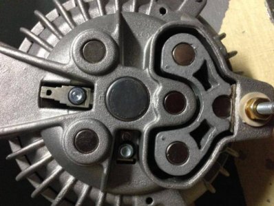

Could someone tell me if this is a single or dual field alternator, and if it is a single field ,can it be converted or would I be better of just getting a dual field
Cheers
That is a single field alternator and should be what came on a 66. If you want a dual field, best to buy them already that way. FYI, it is simple to convert a dual field to a single field by simply grounding one of the field plugs. It is much more difficult to convert the single to the dual (if not impossible).
