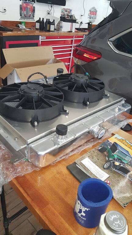

cold case dual fan setup was NOT enough to cool a mild 440.
electric fans are not worth doing. as a person who did it, and reverted back to OEM. im telling you this.
the cooling is marginal at idle. the electric draw is tremendous and will probably force you to upgrade your entire charging circuit.
as soon as I put back a fan clutch and OEM shroud I quit overheating.

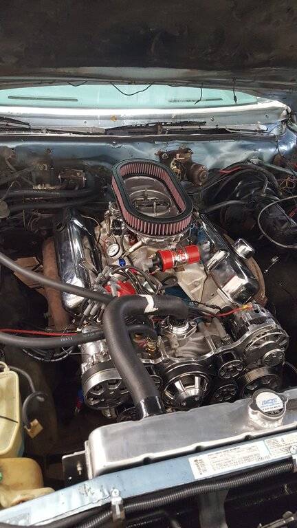

This is what I used in my 1978 NYB with a 500 HP crate engine from CME. It works great!!!
I had to use the Hemi aluminum performance water pump and housing because the radiator inlet and outlet is reverse sides of a Formal.

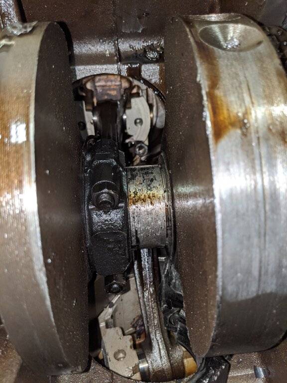

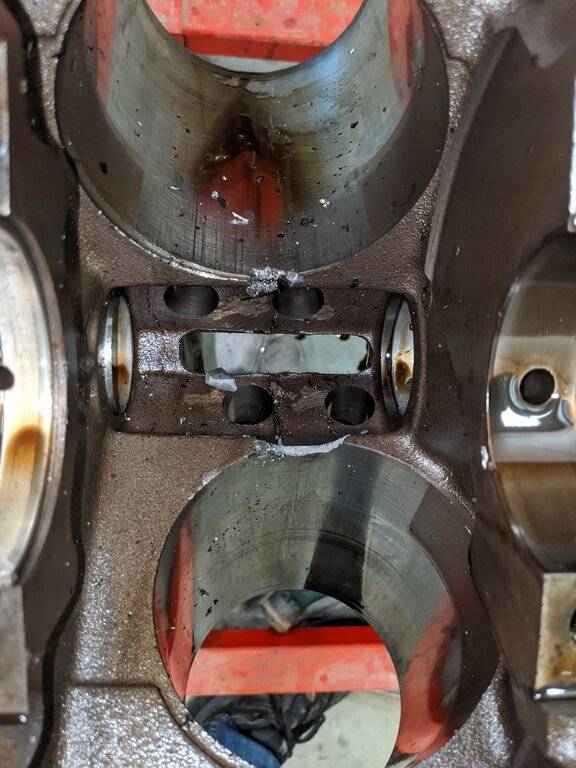

This is a 400 build for one of my Cordoba's. The 400 in it is trashed as you can see by the pictures. Pulled a 400 out of a 78 New ?Yorker parts car.
I used the same brand radiator on my 440. But no fans. Of course its out of stock. Painted it black to blend in. Works well. not the greatest pic
