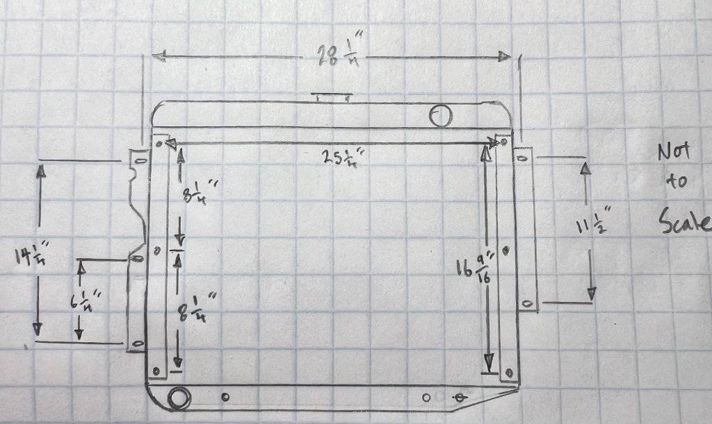

Below is the measurements of my radiator and fan shroud mounting brackets. The measurements are center to center on the holes and fan shroud studs.
Anyone got a solution? Anyone modified any radiators out there to work?
I've got a 2898061 radiator, no leaks and worked fine before I found the correct numbers rad for my 70 cuda and swapped it out. The number refers to a 1968 C-body 383 4bbl w AC. 26 inch. 2 core. On eBay item# 335529911583
Just make adapter plates for the ECP radiator. 2 flat pieces of aluminum from big box. Plus this allows exact lineup of the fan with the shroud. Paint it black if you want old school. Rustoleum ultra high heat BBQ has right sheen and minimal thickness.
