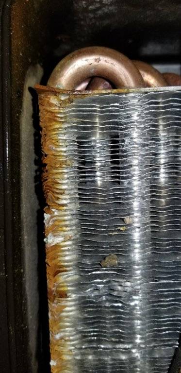

Got it out, core is ugly, seals disintegrate upon touch, except the one against the firewall looked ok, not sure why ac drain is leaking. Evap starting to rust, but was still holding charge, should I replace?
If it is out it’s probably a good idea to replace unless you enjoy taking the box in and out. But if it is holding a charge it could be fine. The rust is probably from water/ condensation sitting in the bottom of the box due to dirt or something blocking the drain for years. New seals and gaskets are probably available from DMT (Detroit Motor Technologies)

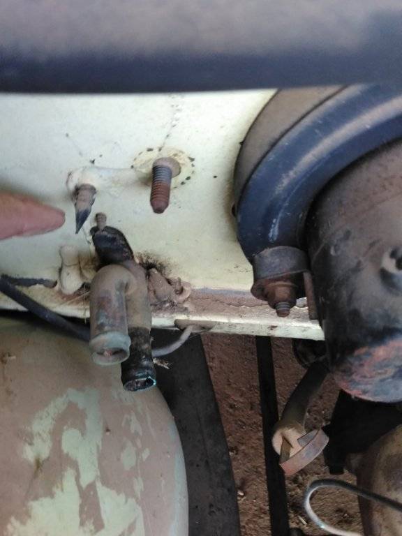

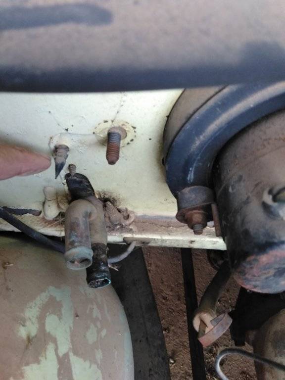

THX! interior is stripped down to the pan. no console, removed glove box - in many pieces - and removed the 5 nuts from the engine side. i see a few black plastic "screws" (for lack of a better term ) sticking thru the firewall in to the engine compartment. do you know if they need to be punched back thru the firewall to get the box out??
thanks again. ill try not to be a pain...

Got a photo of those screws, can't picture it and I have my charger at my house now
Different than a 70, but they don't look like something that'll hang it up

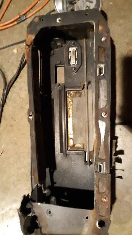

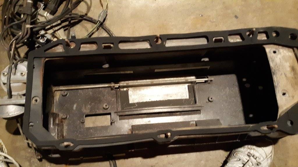

Do not hammer or force the heater box studs through the firewall. You will break the heater box. The heater box configuration ii's the same as the 69-71 Chrysler 300. You must remove the center dash vent assemb to remove the heater box. The studs by the blower motor won't effect heater box removal. Take some photos the heater box under the hood would help. There is no mention what year your car is. The attached photo is of a 69-71 Chrysler 300 heater box. Note the bottom photo how it is broken at the top, this is why you don't hammer or use excessive force on the studs.
