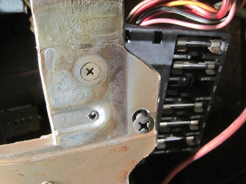

This should help for the fuse box. PO took off the cowling below the steering wheel and one of the screw also holds the fuse box in place. It should be the one furthest to the left.
I don't have the car with me or I would take some more pictures. That will probably be what you really will need to help sort everything out. The PO really did make a mess of things I'm guessing an after market radio was "installed" at some time and he didn't have a clue what he was doing.
Thanks is that next to the vent? Any idea what the switch on the brake pedal is all about? The hose looks like a vacuum line but that seems redundant with the wires coming off of it. Then I have to figure out where the purple wire goes.

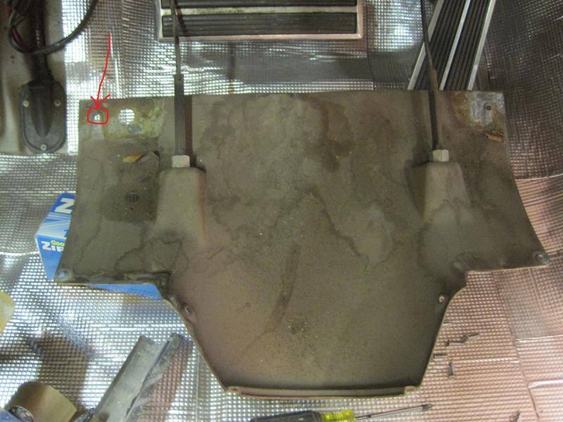

Sorry can't help you on the other but here is a reference with the cowling lowered, you can see the vent pulls.

That helps greatly. Hopefully someone else recoginzes the setup on the brake pedal. If not as soon as the rain stops I'm going to go remove it and see if the one set of brake lights I got working today go out.
