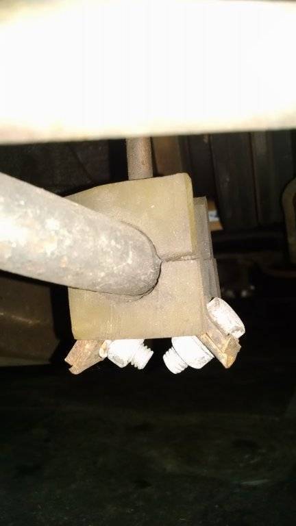

There is a way to replace the encased sway bar bushings. On my '69 NY, I removed the bar and perforated the bushings with a drill so they pretty much crumbled apart. After sliding the bushing brackets off the bar, I drilled a hole in each bracket "ear". I then sawed the welded area of the bracket apart with a band saw so that they separated where each hole was drilled. This allowed me to reassemble the brackets with nuts and bolts, with new poly bushings (made from raw material....none were available at the time). If done this way, you can replace them at will.
Celticwarlock, that is a PERFECT EXPLANATION OF HOW TO. I had thought about drilling holes in the ears, but didn't even think of using a band saw. Where there's a WILL there is a way...I guess my WILL was easier to just get the kit LOL!!

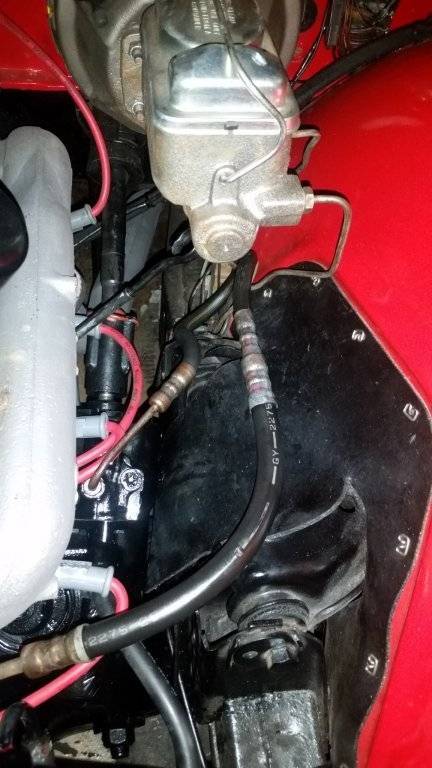

So new gearbox in but no matter where I set pitman arm steering wheel off 90. Off the Firestone for an alignment. There is a guy that like old mopars there. Did an awesome job car drives perfect...but as I pulled on the garage my heart dropped. Ps fluid leaking all over. Cleaned up the mess fearing my cheap box is a pos. Started it in and fluid started running out. Was actually happy when found the leak. Loos like my hose let go at the crimp. New hose ordered..Fml lol. I should have replaced that hose when I put the motor together. Oh well lesson learned
Good to hear it wasn't anything serious! BTW, where did you get the black wheel well covers shown in your pic?
Sorry this image is a little late to the party. If anyone is interested, this a photo of what I did. The fit is much better than the photo may indicate, and the bushing is tan because that is the only color I could get a brick of that stuff in at the time (85 A durometer polyurethane).
Nice job... that was a fair amount of work most wouldn't consider if a new piece was available... but it wasn't at that time. Would you do it again now, or just buy the kit?
What's it called or name description?
They are called splash sheilds. Some reason I cant attach the link. I randomly scroll thru ebay and saw them. I'm always adding parts to my parts closet.lol. I do the same with my renault never know when ya need something. Can't believe I never bought and extra ps hose!
Given that it was pretty easily accomplished, I'd do the work on the brackets again. The bushings were actually fun to make (a drill, hand saw, bench grinder and a paddle bit were all I needed), but those I'd probably buy if the price was right. As for the bushings between the subframe and bracket stems, I used polyurethane end link bushings shaved down to the proper height and size. I simply got ones that were a bit too large and carefully "machined" them with a bench grinder.
