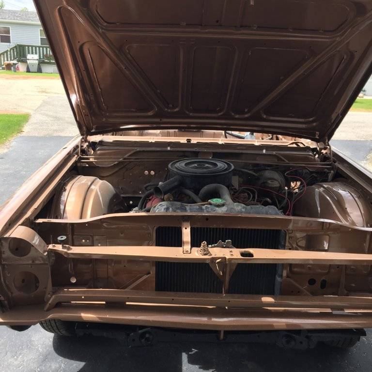

A side issue might be the cost of the paint that went on the '65-'68 cars, to put body paint on those inner fenders. Rather than the less expensive satin black that was "sprayed at" or "dipped into" for the inner fenders on the '69-'73 cars. Less paint spray = less VOCs into the atmosphere. The "dip" was a large container with paint poured on top of water, then the part was dipped into it, while on a holding fixture/hook, then went on down its way to air dry before it got to the assy line. Maybe even a bit ot electrostatic charge to get the paint and metal "together" a little better, as with the anti-corrosion treatment of the car bodies?
